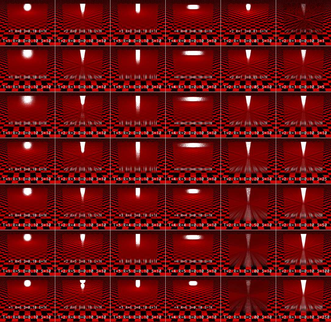

Hello again, I have finally prepared my blurred reflection macro for
distribution.  'BlurRefl.pov' contains the macro plus a sample scene showing
how to use it.  The macro uses fresnel reflection and needs POV 3.5 (3.1
won't work, I'm not sure about megaPOV).  Because it uses fresnel reflection
which needs an ior value, the macro creates a material as opposed to just a
texture (for metal use high iors such as 15 to 25).
'BlurRefl.jpg' illustrates some of the various variables available in the
macro (sorry if there are a lot of jpg artifacts, but I needed to get the
image to a reasonable size for posting).
Layout of image:
T=blur type
R=waveform
D=blur depth
S=# blur samples
the first 4 columns show the effects of the different blur types and wave
form types,
Column 1: T=1, isotropic blur
Column 1: T=2, radial blur
Column 1: T=3, anisotropic horizontal
Column 1: T=4, anisotropic vertical
Row 1: R=0, ramp_wave
Row 2: R=1, triangle_wave
Row 3: R=2, sine_wave
Row 4: R=3, scallop_wave
Row 5: R=4, cubic_wave
Row 6: R=5, poly_wave 0.5  (WF=50.5)
Row 7: R=6, poly_wave 2.0  (WF=52.0)
each of these uses a blur depth (D) of 0.1 and 10 blur samples (S)
column 5 shows the effects of blur depth
each image uses 10 samples, triangle_wave and radial blur (my favourite!)
column 6 shows the effects of the number of samples
each image uses 0.1 blur depth, triangle_wave and radial blur
Please use the macro as you see fit and give any comments, criticism and
suggestions.
Enjoy
-tgq
Download 'BlurRefl.JPG' (184 KB) Download 'BlurRefl.pov.txt' (5 KB)
Preview of image 'BlurRefl.JPG'

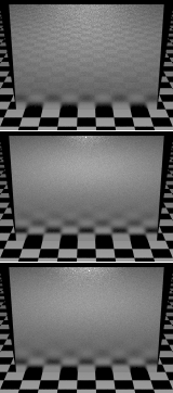

I have had a look at the noise_generator info as suggested.
The following image shows the results using the 3 noise_generators, 1, 2 and
3 (in that order, top to bottom).  The docs state that 0 is also valid but
doesn't say what it is, I am assuming that 0 would force it to use whatever
gets set as the default type, can anyone verify (should this be added to the
docs somewhere?).
Secondly, I would like some feedback here regarding the macro.
Would it be prefered to
1) add (yet) another variable for the user to set the generator type
or
2) force a specific generator type and if so, which one?
Thanks for the info all.
-tgq
PS. I will post the resulting macro in one of the scene-file groups.
Download 'BlurMcro.JPG' (40 KB)
Preview of image 'BlurMcro.JPG'
