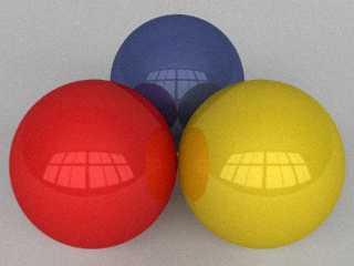

This was just an imitation experiment, but I think I got to fix the
shadows... I really can't remember what I changed, but after too much
tweaking, the strange shadows disappeared.
I added a bit of noise to the image to give it a more "photo" look.
Very simple, but pretty image, I think...
Any comment/suggestion is appreciated.
Fernando.

Honestly, I don't like the noise very much, I think it destroys the
simplicity of the image.
 - Slime
I found that adding Gaussian noise individually to each channel
and twice as much to blue channel duplicated quite accurately
noise in a couple of 6000dpi slide scans. Blue channel is more noisy
in all imaging systems. I scale up the image, add noise, blur a little
to prevent noise aliasing, scale down and mix with original.
Was fresnel and conserve_energy used?

On Sat, 8 Jun 2002 13:23:42 -0500, "Fernando Gonzalez del Cueto"
I think the noise worked well for that purpose. Exactly how did you
add the noise to this image? I wonder if it could be done entirely
within POV-Ray?

"Glen Berry" <7no### [at] ezwvcom> wrote in message
news:RW0CPaS8E54q9I98Bwgw2VvSFWOG@4ax.com...
> within POV-Ray?
I'm glad you liked it. I added the noise using The Gimp, but I really don't
know if it can be done with POV... I doubt it.
Thanks Glen,
Fernando.

Hi Slime,
My newest post displays a weaker noise, and a noise-less versions. Do you
like them better?
Fernando.

"Kari Kivisalo" <pro### [at] luxlabcom> wrote in message
news:3D0265AC.71BAD9AB@luxlab.com...
Hi Kari. In my next post, I make a noised version with your technique, I
think it is better. Thanks!
No... Actually, I've never used them :-/   Would they help?
Fernando.
