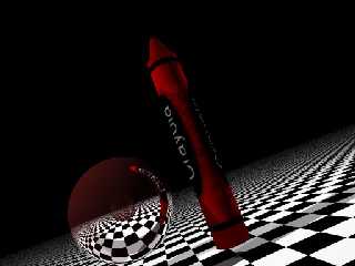

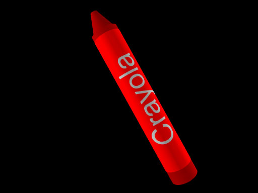

Hello Everyone,
    I wanted to wait to do my first image post with something good..but this
is all I Got now..
    I didn't do the "cliche" ball posts or anything like that.. I was
watching my daughter color one day and though.. I Bet I could do one of
those crayons.
There are a few things missing fromt the crayon, I know.
Ie: The black circle behind "crayola" and the Wavy Border at the top and
bottom.
But I'm a newbie with Pov still.. I know a few things, but not alot, so this
was the best I could do wiht my limited knowledge....
Comments would be appreciated..
Stats:
Scene contains 3 frame level objects; 0 infinite.
Statistics for C:\Program Files\POV-Ray for Windows v3.5\mine\crayon.pov,
Resolution 512 x 384
Pixels:          197770   Samples:         1774730   Smpls/Pxl: 8.97
Rays:           1803556   Saved:                 0   Max Level: 4/5
Ray->Shape Intersection          Tests       Succeeded  Percentage
Cone/Cylinder                  1024425          302826     29.56
Bounding Box                   1875348          870200     46.40
Light Buffer                    880702          675023     76.65
Vista Buffer                   3385350         2157491     63.73
Calls to Noise:                  0   Calls to DNoise:             10
Shadow Ray Tests:           456419   Succeeded:                 2212
Radiosity samples calculated:         67 (0.04 percent)
Radiosity samples reused:         184010
Smallest Alloc:                 25 bytes   Largest:            12056
Peak memory used:           179750 bytes
Time For Trace:    0 hours  2 minutes   2.0 seconds (122 seconds)
    Total Time:    0 hours  2 minutes   2.0 seconds (122 seconds)
POV-Ray finished
Download 'Crayola1.jpg' (27 KB)
Preview of image 'Crayola1.jpg'
From: Slime
Subject: Re: First Image Post
Date: 24 May 2002 00:38:17
Message: <3cedc3b9@news.povray.org>
Well, radiosity probably isn't doing too much, since you have only a single
concave object.
The flaws I see are that the paper needs to be a separate object (give it
some thickness) and a lot less shiney. Give both the paper and the crayon a
small normal map.
 - Slime
[ http://www.slimeland.com/ ]
From: Samuel Benge
Date: 24 May 2002 01:32:11
Message: <3CEDD15F.C1272E60@caltel.com>
> bottom.
An image_map might be the way to go there. Even pov 'purists' use image_maps :)
~ Samuel Benge
sbe### [at] caltelcom

From: Dave Bates {[Norman]}
Date: 24 May 2002 08:08:59
Message: <3cee2d5b$1@news.povray.org>
The label is another object it's an open cylinder. :)
I will play with the normal map and see what I Get.. yeah radiosity made it
brigther.. I Rendered it with it just to see if there was a difference.. :)

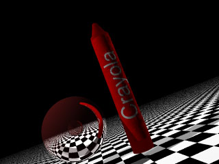

Date: 24 May 2002 08:53:45
Message: <3cee37d9@news.povray.org>
I don't know Maps well enough..so I kinda used one out of the DOC Tutorial
and modified it to look okay..
Added a normal map and some turbulence to the paper..
Took out the RAdiosity and it put the Darkness back to where I remember it..
And I added something just for Marc.. ;)
I originall rotated the camera, so that's why the plane is funny.. :) But I
ThoughtI Would make you all dizzy.. :)
"Dave Bates {[Norman]}" <dab### [at] msncom> wrote in message
news:3cedb450@news.povray.org...
> ( Let's try this again, see if the pic will come through this time)
> Hello Everyone,
this
> is all I Got now..
> those crayons.
> bottom.
this
> Stats:
> POV-Ray finished
Download 'Crayon2.jpg' (30 KB)
Preview of image 'Crayon2.jpg'

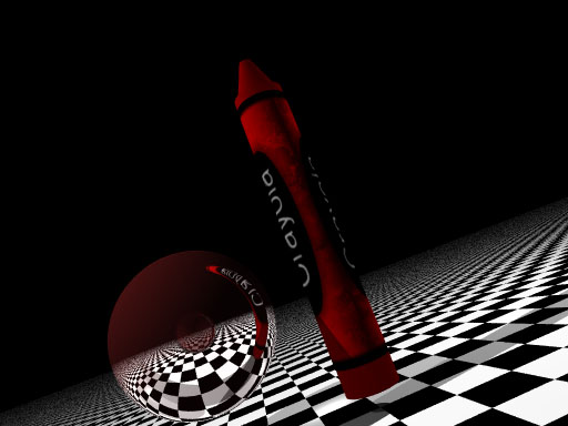

Date: 24 May 2002 22:17:22
Message: <3ceef432@news.povray.org>
Well okay..
Here it is.. my 3rd incarnation of this... Of course.. Now I used an image
map ( that I made myself ) on the label, played with the normal map a little
.. but everything else is the same...
news:3cedac1d$1@news.povray.org...
> Hello Everyone,
this
> is all I Got now..
> those crayons.
> bottom.
this
Download 'Crayon3.jpg' (48 KB)
Preview of image 'Crayon3.jpg'
From: Marc Jacquier
Date: 25 May 2002 13:55:47
Message: <3cefd023@news.povray.org>
Well, well well, Okay, Now you are free to model anything you want ;-)
But why did you put Rad off? Did you try it on?
Marc
