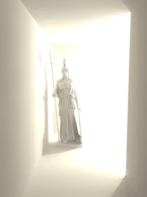

Ok ... now, that I got the model, I can try a bit on
the lighting.
I still have the problem, setting upt the lightsource,
to fit the lighting to the original[1], even without
the object. I played with fade-power, fade-distance,
lightness Rad.-settings and what not... I can't get
the near left wall and the floor be as bright as in the
original and still have the dark corner in the upper
background and the "light-blooming" of the floor from the
left. Interestingly, the most similar resulst I got with
fade-power=0.5 -- (Does that make sense, what I'm writing?)
Now, after having a quite satisfying lightsource, I was about
to tweak the radiosity params, but this is even harder...
I have big problems, with the time of 8m6sec to get the
rendered image (even without Focal blur).
But I still believe, this is my fault, and more advanced users
are probably able to do better. What does our lighting-expert[2]
say, what he whould advice ? Of course, I also like input from
others ;)
Jan ...
[1]
http://www.trinisica.com/img/gallery/imageviewer.asp?image=brazil/b02x_athene_01.jpg&w=480&h=601
[2] Kari, I mean you ... ;)

Where are you placing your light? In the original, it looks as though the light
is aiming at the right back wall, with all the light falling on the left hand
side of the image coming from diffusion. In your version, it looks as though
your light is lighting the statue and problematic areas more directly.

It's certainly tricky to work out what they've done with the light. It says
"pointlight", but the shape looks more like a spotlight. Perhaps it's coming
through an apeture.
Nevertheless, I would try and emulate the round shape of the direct light
illumination (as seen on the back wall and the ceiling), and then go from there.

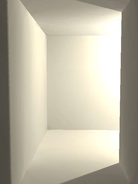

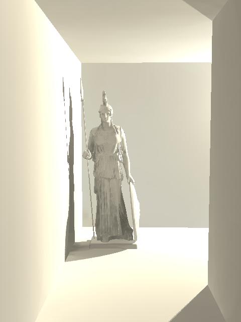

BTW: here's my recent (fast) try ...
Download 'athene.jpg' (16 KB)
Preview of image 'athene.jpg'
From: Jan Walzer
Subject: Re: [brazil] Athene WIP
Date: 29 Apr 2002 13:22:48
Message: <3ccd8168@news.povray.org>
"Tom Melly" <tom### [at] tomandlucouk> wrote :
> If you look at the back wall and the ceiling, it seems round with a defined
> edge? Ignore the light falling on the statue, and just look at the brightest
> light on the back wall/ceiling.
I can create this shape of the light quite good ...
it's a pity, that the rest of the room doesn't nearly look
as I want it to ...
Download 'athene_room.jpg' (10 KB)
Preview of image 'athene_room.jpg'
