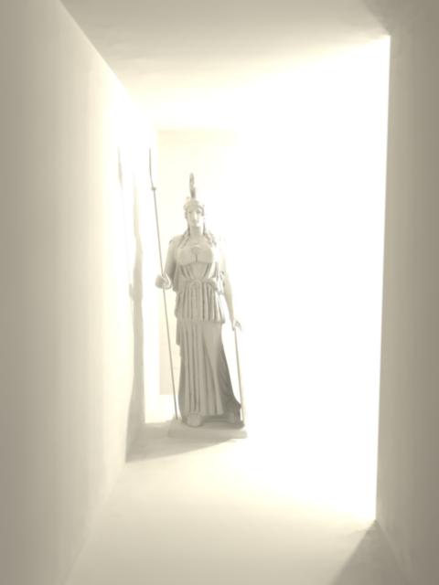

Ok ... now, that I got the model, I can try a bit on
the lighting.
I still have the problem, setting upt the lightsource,
to fit the lighting to the original[1], even without
the object. I played with fade-power, fade-distance,
lightness Rad.-settings and what not... I can't get
the near left wall and the floor be as bright as in the
original and still have the dark corner in the upper
background and the "light-blooming" of the floor from the
left. Interestingly, the most similar resulst I got with
fade-power=0.5 -- (Does that make sense, what I'm writing?)
Now, after having a quite satisfying lightsource, I was about
to tweak the radiosity params, but this is even harder...
I have big problems, with the time of 8m6sec to get the
rendered image (even without Focal blur).
But I still believe, this is my fault, and more advanced users
are probably able to do better. What does our lighting-expert[2]
say, what he whould advice ? Of course, I also like input from
others ;)
Jan ...
[1]
http://www.trinisica.com/img/gallery/imageviewer.asp?image=brazil/b02x_athene_01.jpg&w=480&h=601
[2] Kari, I mean you ... ;)
Download 'athene.jpg' (13 KB)
Preview of image 'athene.jpg'

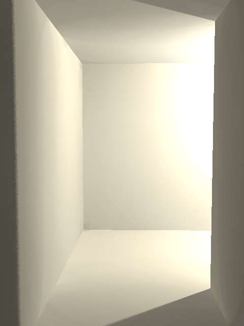

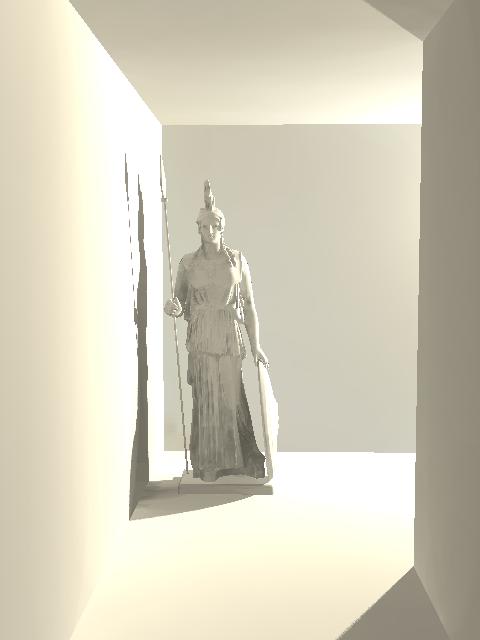

BTW: here's my recent (fast) try ...
Download 'athene.jpg' (16 KB)
From: Jan Walzer
Subject: Re: [brazil] Athene WIP
Date: 29 Apr 2002 13:22:48
Message: <3ccd8168@news.povray.org>
"Tom Melly" <tom### [at] tomandlucouk> wrote :
> If you look at the back wall and the ceiling, it seems round with a defined
> edge? Ignore the light falling on the statue, and just look at the brightest
> light on the back wall/ceiling.
I can create this shape of the light quite good ...
it's a pity, that the rest of the room doesn't nearly look
as I want it to ...
Download 'athene_room.jpg' (10 KB)
Preview of image 'athene_room.jpg'
