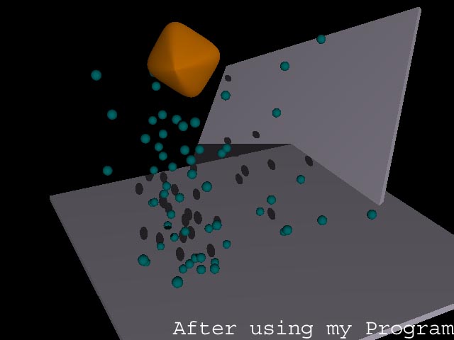

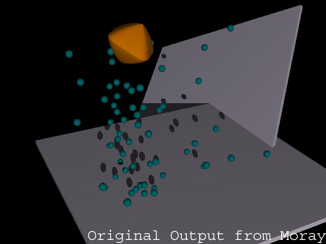

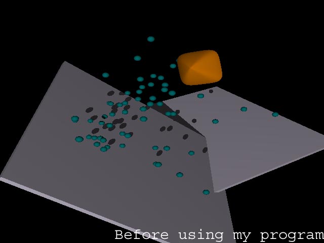

I'm trying to write a program that converts Moray's povray output, which
uses the right hand coordinate system, to povray's native left handed
system. As you can see from the images bellow I'm not quite 1/2 way there
yet. The method I use is simply to comment out the sky and up key words in
Moray's output thereby defaulting to povray's lefthanded system. Then for
all vectors I switch the z and y positions. For example
translate <10,-50,100>
becomes
translate <10,100,-50>
This seems to work fine for translate and scale but rotation is a different
matter all together. I found a way to get rotation to work some of the time
by reversing the sign of the magnitude and rotating around the Z axis before
the y axis, so for example
rotate <-28.678608, -34.926117, 42.857418>
becomes
rotate 28.678608*x rotate 34.926117*z rotate -42.857418*y
As you can see from the image below this works for the rotated box in the
background but not for the superellipsoid in the front. Also I get all kinds
of nightmarish things happening if I try to work with csg and rotation. Can
anyone help here cause I feel like I'm close to a solution.
Home Page: http://www.geocities.com/~thomaslake/

There is an old program out there somewhere that is called Lefter that does
the conversion. You have to make sure to change the *y and *z stuff though.

I have done that in the past with a program I wrote to convert AutoCAD
models to POV.  I used much the same method, but it got a little more
complex with rotations around the y and z axes (they have to be reversed),
and I thing I remember that lathes and prisms are very messy since they can
only be defined in 2-dimensions.  I can email code snippts if you're really
interested.  Hope this helps your cause...

Hmm... See my message/work-around in moray.win.
I think my work-around there might also help with lathes and prisms? I don't
think I tried, but it should work the same as for any CSG object...
Anyway, the conversion is only intended for a group of objects? Not a whole
scene? because that would not make really sense as the end result would be
the same, whether traced in Moray or POV-Ray...
