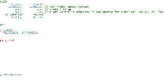

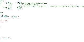

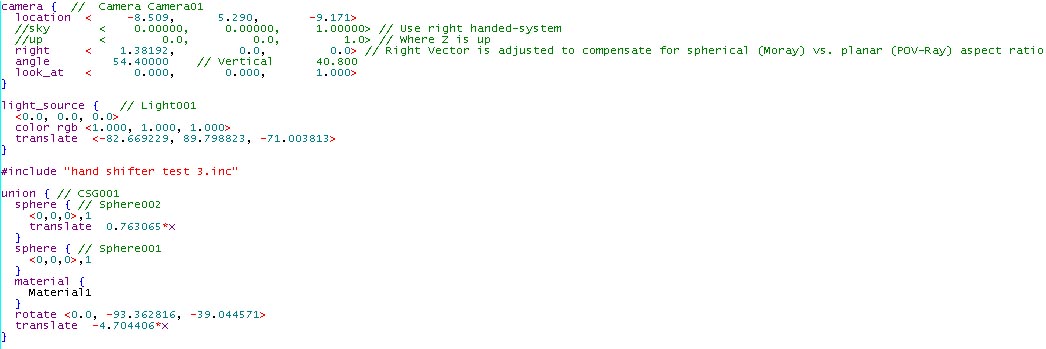

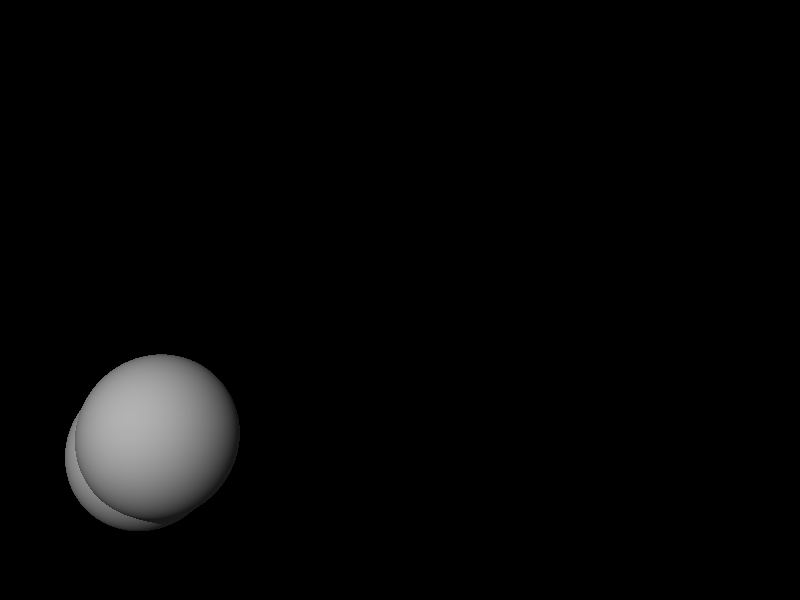

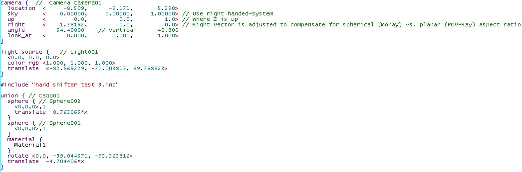

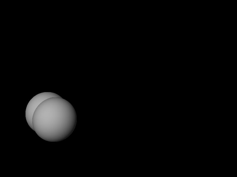

I'm trying to convert this simple scene from moray's right handed system to
povray's left handed system can anyone tell my why this isn't working? The
first piece of code and the first image is the output from moray. The second
piece of code and the second picture is my modification to that code to
convert it to Pov's right handed system. Why are the two images different?

Note: In the povray corected code I forgot to switch the camera's look at
vector to the lefthanded system, however this is not the reason why the 2
look different.

Strange... I think rotating the whole scene -90 degrees around the x axis should
do the trick!
