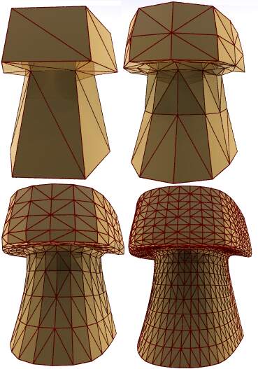

I wanted to make a patch type object that passed through all control points.
After doing some web research, I found that the schemes for which I could
actually find an algorithm were not optimal for this purpose. These
algorithms had all been designed for animation and concentrated on speed of
calculation.
None that I found would put points directly in the centers of all uv squares
even when the control points were laid out in a flat grid. This is because
the algorithms handle corners and sides by increasing the weight of points
near the edges to make up for calculation points which are not present. My
algorithm uses the available points to guess where "missing" control points
might be and assures a proper weight for all points.
The best algorithm I could find that went through all of the control points
worked with triangles only. I prefer to work with squares when possible,
because the selective division of squares suggested to me by Hugo allows for
a better looking surface with far fewer control points. Since this patch
passes through all control points, using squares instead of triangles also
decreases the degree to which the object's shape is forced.
I really wrote this to see if I could do it. I don't think that I will
pursue this much further, because I prefer to build meshes myself with EVERY
point used as a "control point."
What do y'all think of this?
 -Shay
Download 'splitJPG.jpg' (35 KB)
Preview of image 'splitJPG.jpg'
Looks like your going for subdivision surfaces. Is the original model in
quads or tris?
I'm not sure why you want the surface to go through all control points. This
will create hard edges and while it is sometimes wanted I think the point of
subdivision surfaces is to make the model more defined but also somewhat
smoother.
On a sidenote: After 3.5 is finalized I'm gonna start bugging people about
programming subdivision surfaces for POV (You are now on that list of people
 ). I've already approached J. Vansickle about this matter.
-Jide

Jide <jid### [at] kotisoonfi> wrote in message
news:3cc03cf7@news.povray.org...
> quads or tris?
The original model is in quads. They are made into tris for rendering by
choosing the optimal division for the curve. All of the calculations are
done with quads and the output is quads. I created the weight patterns
myself to be used this way.
This
of
> smoother.
Every process except building the mesh entirely by yourself makes the object
*less* defined.
Not going through all control points makes the object much less defined and
much smoother. Passing through all of the control points retains most of the
definition of the object and makes the object somewhat smoother. Ideally,
you should have both options available to you and of course more definition
can be retained in any object by using more control points.
If you are subdividing two objects which are just touching each other,
division through control points will keep them just touching each other
provided the control points are a the location where the objects are
touching.
The two processes are unique and produce a completely different results.
 -Shay
I think this is cool! Very cool. More triangle / quad stuff in Povray is
good. But it's a challange to make macros that are easy and powerful. Well..
the more ideas, the more luck.. Does your macro need the control points to
be in a grid?  For example 3*4 meaning 4 rows with 3 columns each.. That's
typical for macros, but often annoying for me to model in this way.
Your experiments are however steps into an interesting direction.
Hugo

Hugo <hua### [at] post3teledk> wrote in message news:3cc07978@news.povray.org...
Thanks.
It does at the moment, but that can be easily changed. The problem with
making a macro which works on a group of points rather than a grid is that
more is required from the user. The macro in it's current state requires
only an array of points. The use of points not layed out in a pre defined
order requires that the user also input the edges, triangles, or some other
kind of direction specifying the order in which the points are to be used.
With subdivision like this, that need isn't much of an obstacle because so
few control points are used. I may try this over the weekend.
 -Shay
