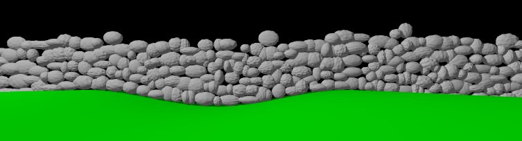

For some reason this was causing me a lot of grief. Started from scratch and
seem to be getting somewhere.... A better approach, and it was easy to get it to
follow the shape of the land.
#macro G(D,E,F)#local I=array[3]{D,E,F}#local B=0;triangle{#while(
B<3)#while(I[B])A[mod(I[B],10)]+#local I[B]=div(I[B],10);#end<-5,-
2,9>#local B=B+1;#end}#end #local A=array[7]{x,x*2,x*4,y,y*2,y*4,z
}light_source{-x*6-z*9,1}mesh{G(105,10,146)G(105,246,10)G(105,56,
146)G(105,1256,246)G(1256,126,220)G(22156,2216,201)pigment{rgb 1}}//TM
Download 'dw2.jpg' (27 KB)
Preview of image 'dw2.jpg'
Subject: Re: dry stone wall - getting there....
Date: 11 Apr 2002 11:40:17
Message: <3CB5AE5D.FF2C063@gmx.de>

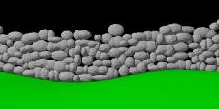

Nice, but the individual stones look a bit too uniformly oval, it's
probably difficult to build a wall with more irregularly formed stones,
but you could try blob-like shapes.
Last updated 18 Mar. 2002 _____./\/^>_*_<^\/\.______
From: Tom Melly
Date: 11 Apr 2002 11:50:23
Message: <3cb5b0bf$1@news.povray.org>
news:3CB### [at] gmxde...
Oh - that's not really a problem. Each stone is a different iso-surface, just
not different enough yet. The main problem is some merging of seperate stones,
but I don't think that's going to show up.
Here's the code so far (God, I love trace):

From: Defective

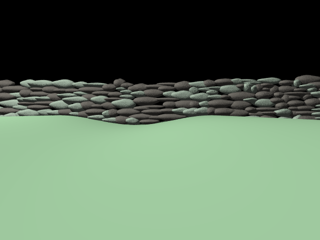

Do these stones look better?
Hope you solve the merging stones issue soon...I can't wait to build the
perimeter wall in my ongoing homestead project with this.  (It'll take weeks
to parse, but what the heck... :)
Scott
Download 'Stone Wall!2.png' (89 KB)
Preview of image 'Stone Wall!2.png'

Definite improvement. Still a lot of overlap, however.

only 2 things I see wrong is the top layer should be smoother, and they all
look like peanuts :)
Corey

Ooo, nice. I suspect for my needs I need to hunt down some ref. photos.
I don't know if the merging stones problem can really be resolved* - at least
not without a huge chunk of flaky code. What size are your base stones? At the
moment the macro only really works with stones w/ radius =1.
* changing the line
#declare TraceX = TraceX + (2*XScale);
to, for example
#declare TraceX = TraceX + (3*XScale);
would make a merge less likely in the x dimension.
From: Defective
Date: 12 Apr 2002 15:15:03
Message: <3cb73237$1@news.povray.org>
"Tom Melly" <tom### [at] tomandlucouk> wrote in message
news:3cb6bf59$1@news.povray.org...
I ripped the following rocks from isocacti.pov (in the sample scenes) and
created a macro, then plugged it into your code:
#macro Rock3(SEED)
    #local RS = seed(SEED);
    #local RockColors = array[5]
     color rgb < 0.5, 0.4, 0.35>,
     color rgb < 0.4, 0.5, 0.4>,
     color rgb < 0.8, 0.75, 0.65>,
     color rgb 0.8,
     color rgb 0.5
    #local TexNum = RRand(0.1, 1, RS);
    #local Scale = rand(RS);
    #local RotY = rand(RS);
    isosurface {
     function {f_r(x, y, z) - 1 + f_noise3d(x, y, z)*0.5}
     threshold 0
     contained_by {sphere {o, 1}}
     #if(Scale < 0.5) scale VRand_In_Box(< 1, 0.9, 1>, < 2, 1, 3>, RS) #end
     rotate y*RotY*360
     translate -y*0.35
     texture {
      pigment {Rand_Array_Item(RockColors, RS)*TexNum}
      normal {granite bump_size 0.5 scale 0.01}
#end // Rock3
least
the
> * changing the line
> to, for example
Trying that as I type this...
Dang!  No improvement.  Guess I better take another look at the rock
dimensions.
Scott
