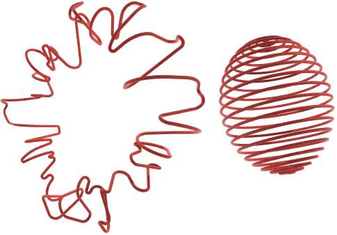

This is the result of a macro that I thought of on the way to work
yesterday. Each of these sphere_sweep knock-offs has 100 control points and
either will render on my machine in about 4 seconds without AA! (that won't
mean much to you if you haven't used sphere_sweep before, but if you
have...)
This isn't a replacement for sphere_sweep, but if all that is required is a
smooth curve controlled by a group of points, then this can be used to make
one very quickly.
 -Shay

The user puts the control points into an array. (I *think* I understood the
question) Then the macro then builds a CSG "sweep."
> Will you post your macro?
I will post the code for the macro, but posting three buggy versions of
another macro to pbs-f a week or two ago has taught me a lesson. I will use
the macro for a while first to make SURE that I have not missed and
mistakes.
 -Shay

The sweeps are made up mostly of tori. The first sweep has only 196 objects,
not sure about the second. This is what makes the render so fast.

I looked at Tor's code that Hugo posted and he uses a completely different
method. His method makes a torus segment with ends on two control points. My
method makes a torus segment which may pass through no control points and
has its ends at the midpoints between a point and its previous and next
points.
I considered Tor's method, but the method I chose is more appropriate for
the kinds of objects I designed it to create. (Cables, tubing, piping, etc.)
Attached is a picture showing the same set of control points and the output
of each macro. My macro produced the red sweep, Tor's the blue.
 -Shay

The red line is much better! It's predictable. I'm looking forward to your
macro.
