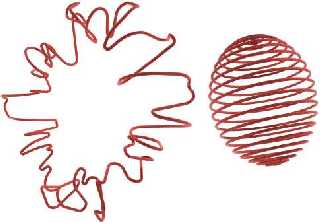

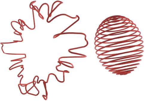

This is the result of a macro that I thought of on the way to work
yesterday. Each of these sphere_sweep knock-offs has 100 control points and
either will render on my machine in about 4 seconds without AA! (that won't
mean much to you if you haven't used sphere_sweep before, but if you
have...)
This isn't a replacement for sphere_sweep, but if all that is required is a
smooth curve controlled by a group of points, then this can be used to make
one very quickly.
 -Shay

From: Spock
Subject: Re: Cheap Sweep
Date: 27 Mar 2002 11:12:23
Message: <3ca1ef67$1@news.povray.org>
Cool.  How do you set up the control points?  Will you post your macro?

From: Shay
Date: 27 Mar 2002 12:19:13
Message: <3ca1ff11$1@news.povray.org>
Spock <spo### [at] nospamcom> wrote in message news:3ca1ef67$1@news.povray.org...
> Cool
Thank you.
The user puts the control points into an array. (I *think* I understood the
question) Then the macro then builds a CSG "sweep."
I will post the code for the macro, but posting three buggy versions of
another macro to pbs-f a week or two ago has taught me a lesson. I will use
the macro for a while first to make SURE that I have not missed and
mistakes.
 -Shay
From: Shay
Date: 27 Mar 2002 17:29:58
Message: <3ca247e6$1@news.povray.org>
Hugo <hua### [at] post3teledk> wrote in message
news:3ca2244f$1@news.povray.org...
> I'm looking forward to see if these sweeps are made up of thousands of
small
> spheres, a few hundred cylinders, or a bunch of torus? Eventually torus's
> would be the best solution (?).
The sweeps are made up mostly of tori. The first sweep has only 196 objects,
not sure about the second. This is what makes the render so fast.
> I've seen a macro for this already, but it
> uses it's own kind of spline, that acts a little wierd.
Do you remember where you saw this? I would very much like to take a look.
 -Shay

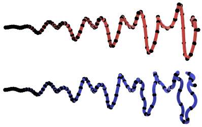

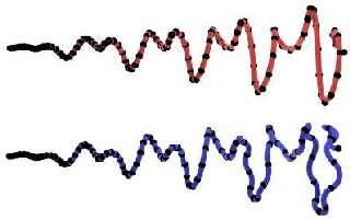

From: Shay
Subject: Similar, but definitely different
Date: 28 Mar 2002 10:19:02
Message: <3ca33466@news.povray.org>
I looked at Tor's code that Hugo posted and he uses a completely different
method. His method makes a torus segment with ends on two control points. My
method makes a torus segment which may pass through no control points and
has its ends at the midpoints between a point and its previous and next
points.
I considered Tor's method, but the method I chose is more appropriate for
the kinds of objects I designed it to create. (Cables, tubing, piping, etc.)
Attached is a picture showing the same set of control points and the output
of each macro. My macro produced the red sweep, Tor's the blue.
 -Shay

From: Hugo
Subject: Re: Similar, but definitely different
Date: 28 Mar 2002 11:23:23
Message: <3ca3437b$1@news.povray.org>
The red line is much better! It's predictable. I'm looking forward to your
macro.
Hugo
