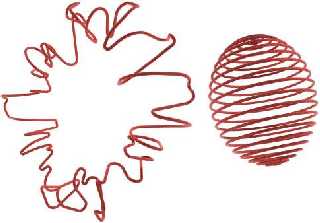

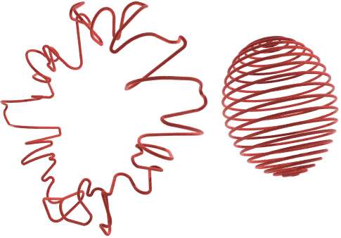

This is the result of a macro that I thought of on the way to work
yesterday. Each of these sphere_sweep knock-offs has 100 control points and
either will render on my machine in about 4 seconds without AA! (that won't
mean much to you if you haven't used sphere_sweep before, but if you
have...)
This isn't a replacement for sphere_sweep, but if all that is required is a
smooth curve controlled by a group of points, then this can be used to make
one very quickly.
 -Shay

From: Spock
Subject: Re: Cheap Sweep
Date: 27 Mar 2002 11:12:23
Message: <3ca1ef67$1@news.povray.org>
Cool.  How do you set up the control points?  Will you post your macro?

From: Shay
Date: 27 Mar 2002 12:19:13
Message: <3ca1ff11$1@news.povray.org>
Spock <spo### [at] nospamcom> wrote in message news:3ca1ef67$1@news.povray.org...
> Cool
Thank you.
The user puts the control points into an array. (I *think* I understood the
question) Then the macro then builds a CSG "sweep."
I will post the code for the macro, but posting three buggy versions of
another macro to pbs-f a week or two ago has taught me a lesson. I will use
the macro for a while first to make SURE that I have not missed and
mistakes.
 -Shay

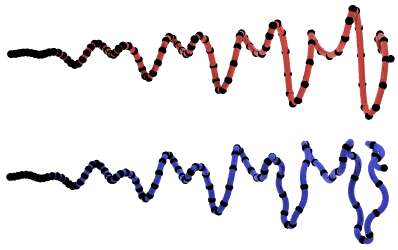

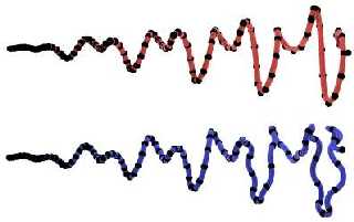

From: Shay
Subject: Similar, but definitely different
Date: 28 Mar 2002 10:19:02
Message: <3ca33466@news.povray.org>
I looked at Tor's code that Hugo posted and he uses a completely different
method. His method makes a torus segment with ends on two control points. My
method makes a torus segment which may pass through no control points and
has its ends at the midpoints between a point and its previous and next
points.
I considered Tor's method, but the method I chose is more appropriate for
the kinds of objects I designed it to create. (Cables, tubing, piping, etc.)
Attached is a picture showing the same set of control points and the output
of each macro. My macro produced the red sweep, Tor's the blue.
 -Shay

From:
Subject: Re: Similar, but definitely different
Date: 28 Mar 2002 10:35:21
Message: <pdd6auo66m8l54b54hljva26jsis0j79i7@4ax.com>
On Thu, 28 Mar 2002 09:20:10 -0600, "Shay" <sah### [at] simcopartscom> wrote:
> I looked at Tor's code ...
I know we know one Tor. But afaik it's not Tor's code :-)
ABX
From: Shay
Date: 28 Mar 2002 10:42:35
Message: <3ca339eb$1@news.povray.org>
news:pdd6auo66m8l54b54hljva26jsis0j79i7@4ax.com...
> ABX
My mistake. I saw the title TorSpline.pov and just assumed.
 Proper credit belongs to
// Auth: Ronald L. Parker
 -Shay
From: Hugo
Date: 28 Mar 2002 11:23:23
Message: <3ca3437b$1@news.povray.org>
The red line is much better! It's predictable. I'm looking forward to your
macro.
Hugo
