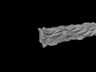

How do/can you make a isosurface box that has a "rough" surface?
I have a (poor) image I made by hand of a "turbulent" box shape.  Basically
I am trying to
make boxes that look like randomly made rectangular stones that have been
placed within
a stone wall (like a fireplace) but have been chipped to be somewhat
rectangular so they
can be placed somewhat close together.
Download 'Image1.jpg' (3 KB)

That type would certainly be close. I am looking for a more "slate
like"/"platey" appearance but that might get me started.
Can you be more specific about the function?  I have tried the function but
simply end up with a "rounded box." I tried:
  isosurface {
     function {f_rounded_box(x,y,z, 0.25, 0.25, 0.25, 0.25) }
     pigment{Red}
     scale 0.5
I'm no math whiz so I'm really not certain what the last four values should
really be.  I've tried various values but always end up with a simple
rounded box.  How do you get yours to look so randomish?  I even tried using
a noise function like this:
  isosurface {
     function {f_rounded_box(x,y,z, f_noise3d(0, y, z), f_noise3d(0, y, z),
f_noise3d(0, y, z), f_noise3d(0, y, z)) }
     pigment{Red}
     scale 0.5
to no avail.  I've used Povray for many years but I am find isosurfaces to
be a bit of a black art.

Well I have read the tutorials and attempted to create "something" that I
was pretty certain
would make a rough box shape.  Instead it is perfectly square.  For example:
 isosurface {
     function { f_rounded_box(x,y,z,0,1,1,1) - f_noise3d(x*5, y*5, z*5)*
0.25 }
     pigment{Red}
     scale 0.2
I wanted a sharp cornered rounded box with some turbulence to it. I felt the
second function
f_noise3d(x*5, y*5, z*5)* 0.25
(shown in the tutorial under the sphere example) should do what I wanted.
From the tutorial it

I tried:
 isosurface {
     function { f_rounded_box(x,y,z,0,1,1,1) - f_noise3d(x, y, z)* 0.25 }
     contained_by { box { -1 , 1} }
     pigment{Red}
     scale 0.2
but this yields a perfectly square box.  No roughness at all.  Would the
max_gradient make or break this?

    I was just doing that too after talking to Tom about stone walls and
talking to my lovely wife about the stone wall we want in the front yard.
Here's what I've got so far, there are some odd things in it from left over
experiments but I think the basics are there. Hopefully it doesn't wrap
funny...
////////////// Camera //////////////////////
camera {                                  //
        right      <  1.333, 0.0, 0.0 >   //
        up         <  0.0, 1.0, 0.0 >    //
        direction  <  0.0, 0.0, 1.0 >     //
        location   <  3.0, 3.0, 7.0 >
        look_at    <  0.0, 0.0, 0.0 >     //
////////////// end Camera //////////////////
///////////////  Light  ////////////////
light_source { < 1000.0, 1000.0, 1000.0 >
color rgb < 1.0, 1.0, 1.0 > }
#declare Rock=function{
                 pigment{
                         crackle
                         turbulence 0.25
                         color_map { [0 rgb 1] [1 rgb 0] }
                         scale < 0.5, 0.25, 0.5 >*3
#declare Wall1 = function { max((x*x*x-1),(y*y-1),(z*z-1)) }
#declare RockWall =
           isosurface {
              function {
                         Wall1(x,y,z)
                        +Rock(x,y,z).x
                        *0.5
              contained_by { box { <-8.0,-1.5,-1.5 >,
                                   < 8.0, 1.5, 1.5 > }
              accuracy 0.0001
              max_gradient 25
              pigment { rgb 1 }
              finish  { ambient 0.125 }
              translate < 0.0, 0.0, 0.0 >
 object { RockWall }
Download 'RockWall02.jpg' (15 KB)
Preview of image 'RockWall02.jpg'
