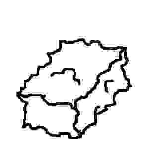

How do/can you make a isosurface box that has a "rough" surface?
I have a (poor) image I made by hand of a "turbulent" box shape.  Basically
I am trying to
make boxes that look like randomly made rectangular stones that have been
placed within
a stone wall (like a fireplace) but have been chipped to be somewhat
rectangular so they
can be placed somewhat close together.
Download 'Image1.jpg' (3 KB)

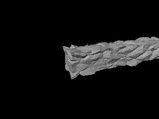

Have a look at:
http://www-public.tu-bs.de:8080/~y0013390/pov/wtunnel.html
for an example (note this is megapov syntax).
The isosurface tutorial in the Povray 3.5 docs should also give sufficient
explanation how to add 'roughness' to a shape.

That type would certainly be close. I am looking for a more "slate
like"/"platey" appearance but that might get me started.
> rectangular so they
    I was just doing that too after talking to Tom about stone walls and
talking to my lovely wife about the stone wall we want in the front yard.
Here's what I've got so far, there are some odd things in it from left over
experiments but I think the basics are there. Hopefully it doesn't wrap
funny...
////////////// Camera //////////////////////
camera {                                  //
        right      <  1.333, 0.0, 0.0 >   //
        up         <  0.0, 1.0, 0.0 >    //
        direction  <  0.0, 0.0, 1.0 >     //
        location   <  3.0, 3.0, 7.0 >
        look_at    <  0.0, 0.0, 0.0 >     //
////////////// end Camera //////////////////
///////////////  Light  ////////////////
light_source { < 1000.0, 1000.0, 1000.0 >
color rgb < 1.0, 1.0, 1.0 > }
#declare Rock=function{
                 pigment{
                         crackle
                         turbulence 0.25
                         color_map { [0 rgb 1] [1 rgb 0] }
                         scale < 0.5, 0.25, 0.5 >*3
#declare Wall1 = function { max((x*x*x-1),(y*y-1),(z*z-1)) }
#declare RockWall =
           isosurface {
              function {
                         Wall1(x,y,z)
                        +Rock(x,y,z).x
                        *0.5
              contained_by { box { <-8.0,-1.5,-1.5 >,
                                   < 8.0, 1.5, 1.5 > }
              accuracy 0.0001
              max_gradient 25
              pigment { rgb 1 }
              finish  { ambient 0.125 }
              translate < 0.0, 0.0, 0.0 >
 object { RockWall }
Download 'RockWall02.jpg' (15 KB)
