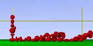

I'm working on a macro that will hopefully eventually generate a dry-stone wall,
but I'm running into problems. In the image below, the wall should approx. fill
the area marked out by the yellow cylinders, but it ain't.
If anyone can be bothered to:
a) work out what I'm trying to do
b) work out how I'm trying to do it
and
c) what's going wrong
then here is the code:

... and here is the image

From: Bill DeWitt
Subject: Re: Dry stone wall - help! [12.4KB]
Date: 22 Mar 2002 09:53:22
Message: <3c9b4562@news.povray.org>
"Tom Melly" <tom### [at] tomandlucouk> wrote in message
news:3c9b304f@news.povray.org...
wall,
fill
> and
    Well, skipping a) and b) and looking only at the image, it looks like
you have a mismatched loop somewhere. It goes across but not up. I will take
a few more minutes to look it over but so far your method befuddles* me.
    *Remembering that I am easily befuddled by math-like thingies.

From: Shay
Subject: Re: Dry stone wall - I see the problem
Date: 22 Mar 2002 10:02:18
Message: <3c9b477a$1@news.povray.org>
Trace hits all of the stones in the first row, because they are all stacked
in a straight line. On subsequent rows, the trace is only hitting
occasionally. One miss starts you back on the ground.
 -Shay
Tom Melly <tom### [at] tomandlucouk> wrote in message
From: Tom Melly
Date: 22 Mar 2002 10:09:51
Message: <3c9b493f$1@news.povray.org>
"Bill DeWitt" <bde### [at] cflrrcom> wrote in message
news:3c9b45fe$1@news.povray.org...
>   #while(ThisLen <= WallLen & ThisHi <= WallHi)
>     Doesn't the above fail as soon as one of the conditions are met?
> Shouldn't they be in two statements, one repeating until the other fails?
Ah! I think that's it - it should be an "or" rather than an "and". Ta.
From: Tom Melly
Date: 22 Mar 2002 10:10:30
Message: <3c9b4966$1@news.povray.org>
"Shay" <sah### [at] simcopartscom> wrote in message news:3c9b477a$1@news.povray.org...
Hmm, no I think that's alright. At any rate, it's intended.... I think Bill has
spotted it.
