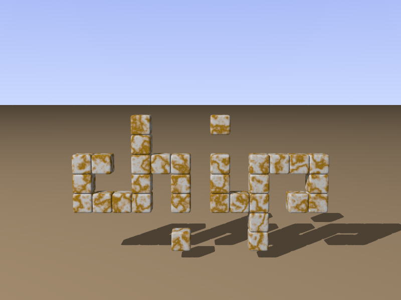

I thought I would try my hand at a sig file, since everyone else seems
to have one.
Cheers!
Chip Shults
#declare Z=texture{pigment{crackle}finish{specular.5}};#macro B(a,b)
box{-.5,.5translate<a,b,0>texture{Z}}#end#macro C(a,b)sphere{0,.5
translate<a,b,-.5>texture {Z}}#end#macro N(a,c)#declare
k=0;#while(k<6)#if((c/2)!=int(c/2))B(a,k-1)B(-a,-k+1)#end#declare
c=int(c/2);#declare
k=k+1;#end#end
N(-6,7)N(-5,5)N(-4,1)N(-3,31)N(-2,4)N(-1,7)C(-1,-3)C(1,3)//chip

Subject: Re: Check out the new signature
Date: 22 Mar 2002 04:43:58
Message: <3c9afcde@news.povray.org>
Thank you very much for your help.  Although I have used POVray for
about a year, I have not yet used macros with it, so this is my first
experience.  I sort of expected C-style operators but found that they did
not work as expected, so there is a little learning curve there.  After
Steve's remarks, I rewrote the signature to a much smaller version, and your
comments and notes helped make it smaller still.  I found a better packing
algorithm and I will continue to reduce it.
Cheers!
Chip Shults
#macro B(a,b)superellips
oid{<.2,.2>scale.5translate<a,b,3>pigment{agate}}#end
#macro N(a,c)#local k=0;#while(k<6)#if(mod(c,2))B(k+1,a-2)B(-k-1,-a+2)#end
#local c=int(c/2);#local k=k+1;#end#end N(3,61)N(2,37)N(1,55)N(0,4)N(-1,4)
B(-1,-3)B(1,3)
Download 'Newsig03.jpg' (32 KB)
Preview of image 'Newsig03.jpg'
