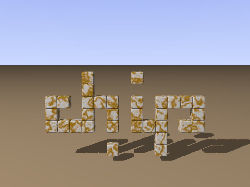

I thought I would try my hand at a sig file, since everyone else seems
to have one.
Cheers!
Chip Shults
#declare Z=texture{pigment{crackle}finish{specular.5}};#macro B(a,b)
box{-.5,.5translate<a,b,0>texture{Z}}#end#macro C(a,b)sphere{0,.5
translate<a,b,-.5>texture {Z}}#end#macro N(a,c)#declare
k=0;#while(k<6)#if((c/2)!=int(c/2))B(a,k-1)B(-a,-k+1)#end#declare
c=int(c/2);#declare
k=k+1;#end#end
N(-6,7)N(-5,5)N(-4,1)N(-3,31)N(-2,4)N(-1,7)C(-1,-3)C(1,3)//chip

On Fri, 22 Mar 2002 01:28:09 -0500, "Sir Charles W. Shults III"
> to have one.
it produces black image in my 3.5b13 installation
I have tested this with #version 3.1 at beginig
any hint how to force this ?
ABX

From:
Subject: Re: Check out the new signature
Date: 22 Mar 2002 03:36:01
Message: <5hql9ug1n6hdikqds951ct0ait9suu3tko@4ax.com>
> to have one.
Ok, my notes
use #local instead of #declare
use #default to avoid texture in objects
don't use texture if you not use light (or use it with visible values
if you use black objects on black background then good luck ;-)
> #macro B(a,b) box{ -.5,.5translate<a,b,0>texture{Z}}#end
default camera is at z=0 so move your object somewhere deeper (z>0)
if you use #default then you can avoid texture in object at all
it could more confuse when _ would be used instead of B
> #macro C(a,b)sphere{0,.5 translate<a,b,-.5>texture {Z}}#end
no need to translate sphere, just use translation as center
> #macro N(a,c)
> #declare k=0;
use #local
> #while(k<6)
 if you want small loop then recursion saves a lot of space
 can be replaced with one mod(c,2) calculation
> B(a,k-1)
> B(-a,-k+1)
have you noticed that both calls have 1 and -1 factor for parameters ?
so put only factor to macro, and multi[ply parameters inside macro
> #end
> #declare c=int(c/2);
> #declare k=k+1;
use #local or even replace #while with recursion
and remove declarations at all
> #end
> #end
no need to declare macro C and use it twice, space of this macro is larger
then two unrolled spheres.
Finally check my version of your macro. Feel free to add apropriate light and
pigment :-)
#macro c(h,i,p)#if(i<6)c(int(h/2)i+1p)#if(mod(h,2))_(1)_(-1)#end#end#end//chip
background{1}#macro _(s)box{-.5,.5translate<s*p,s*i-s,19>}#end sphere{<1,3,19>
.5}sphere{<-1,-3,19>.5}c(7,0,-6)c(5,0,-5)c(1,0,-4)c(31,0,-3)c(4,0,-2)c(7,0,-1)
ABX
Date: 22 Mar 2002 04:43:58
Message: <3c9afcde@news.povray.org>
Thank you very much for your help.  Although I have used POVray for
about a year, I have not yet used macros with it, so this is my first
experience.  I sort of expected C-style operators but found that they did
not work as expected, so there is a little learning curve there.  After
Steve's remarks, I rewrote the signature to a much smaller version, and your
comments and notes helped make it smaller still.  I found a better packing
algorithm and I will continue to reduce it.
Cheers!
Chip Shults
#macro B(a,b)superellips
oid{<.2,.2>scale.5translate<a,b,3>pigment{agate}}#end
#macro N(a,c)#local k=0;#while(k<6)#if(mod(c,2))B(k+1,a-2)B(-k-1,-a+2)#end
#local c=int(c/2);#local k=k+1;#end#end N(3,61)N(2,37)N(1,55)N(0,4)N(-1,4)
B(-1,-3)B(1,3)

On Fri, 22 Mar 2002 04:43:53 -0500, "Sir Charles W. Shults III"
But you probably missed some important notes. The key for use povsig is: copy
sig from post and render _without_ modifications. I can't render your sig
without modifications. I have to add camera and light at least. That's wrong
way. Try to make your sig compatible with default value of camera and change
your finish/background/lightning to make object visible. Check in
http://10best.raytrace.com/short/shortvote.html how nice things can be done
with small amount of characters playing only with default values. Remeber -
nothing additional should be done by the user to render your sig!
ABX
