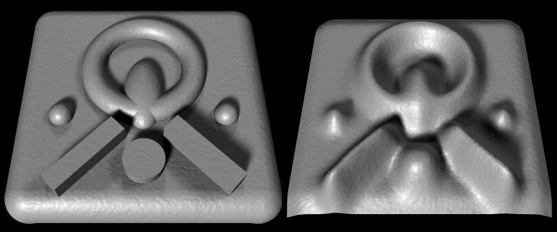

Hi POV'ers!
Here's an example of my macros so far. The left object is POV primitives.
The right object is a traced and blurred heightfield, done with my macros.
The reason why it looks a bit stretched in the Y direction is a bug, but I
planned it as an effect anyway (that you can turn off).
I think the quality is fair, given the grid is only 64*64. The macros are
very easy to use. They don't require the same math knowledge as isosurfaces.
I know this will please some.  :o)  But they're limited to making
heightfields. There will usually be some artifacts compared to your original
object, but it's not necessarely going to look bad.
I haven't yet programmed cylindrical heightfields, because I'm confused over
function {}.. I think the best is to have the user specify a function for
this, but Pov complains when I try to get it into my vertex position loops.
Parsing is a bit slow while the mesh is being build.. The attached image
needed 40 seconds to parse on my 1 ghz computer, but the resulting mesh2 can
be saved & loaded in all your future scenes, and then it will be very fast.
I'll release the macros soon. I don't know how useful you think this is, but
in some cases I think, I can use it myself.. I also tried to code in a clean
way so other people can add to it..
Hugo

From: Shay
Subject: Re: First example of my HF macros
Date: 7 Mar 2002 09:56:40
Message: <3c877fa8@news.povray.org>
That looks AWESOME. I can see a lot of utility with this macro for making
thinks like stamped text, worn stone tablets, knobby bronze objects, etc. I
have tried creating this effect in the past with a low resolution
heightfield, but without your square dividing algorithm, the results were
quite poor.
If you can wait for just one more day, I have been doing some speed
experiments and can speed up the normalizing algorithm a LOT. I have removed
the extra steps from the algorithm, "functionalized" all of my formulas, and
combined some processes. And in defense of all of my rewrites. I can at
least say that my first version worked as intended. <g>
   -Shay

From: Hugo
Date: 7 Mar 2002 11:25:50
Message: <3c87948e@news.povray.org>
Hi Shay,
I'm glad you like it! I must admit the normalizing code is still the one
from your first version. I have been busy with implementing vertex-blurring
(not connected with normal smoothing). And I use a fixed 4 times
"oversampling" during trace of the original object, that improves shape. All
in all those things add to the parse time, but none of them are extremely
slow by themselves.
I'd very much like to see what you have in mind. I have no idea how it works
as a function {} But before you spend a lot of time writing new code, maybe
I should show how I implemented the first one. It was the section about
storing normals in an array, that I really needed, the rest was already
working in my code. So I removed my normal junk-code and used this:

From: Hugo
Date: 7 Mar 2002 17:17:22
Message: <3c87e6f2$1@news.povray.org>
> Tor said in another thread that normalizing sums of
> the non-normalized vcross of each triangle would
> give the correct weighted normal, and he was correct
Does this mean, I'm now using weighted normals and not just averaged ones?
I actually didn't know.  It's some time ago I decided to skip vnormalize
until the very end as this seemed logical. But I don't always know what I'm
doing.
> I am pretty sure that vcross(V2-V1,V1-V3) gives
> a more accurate result
I'll try, thanks for the tip!
Regards
Hugo
