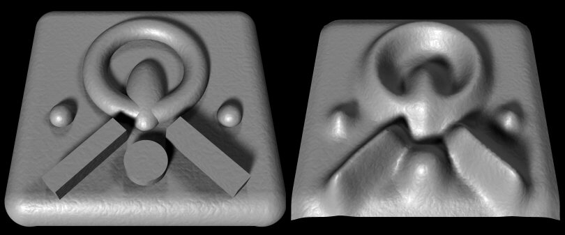

Hi POV'ers!
Here's an example of my macros so far. The left object is POV primitives.
The right object is a traced and blurred heightfield, done with my macros.
The reason why it looks a bit stretched in the Y direction is a bug, but I
planned it as an effect anyway (that you can turn off).
I think the quality is fair, given the grid is only 64*64. The macros are
very easy to use. They don't require the same math knowledge as isosurfaces.
I know this will please some.  :o)  But they're limited to making
heightfields. There will usually be some artifacts compared to your original
object, but it's not necessarely going to look bad.
I haven't yet programmed cylindrical heightfields, because I'm confused over
function {}.. I think the best is to have the user specify a function for
this, but Pov complains when I try to get it into my vertex position loops.
Parsing is a bit slow while the mesh is being build.. The attached image
needed 40 seconds to parse on my 1 ghz computer, but the resulting mesh2 can
be saved & loaded in all your future scenes, and then it will be very fast.
I'll release the macros soon. I don't know how useful you think this is, but
in some cases I think, I can use it myself.. I also tried to code in a clean
way so other people can add to it..
Hugo
Download 'HFmacros.JPG' (39 KB)
Preview of image 'HFmacros.JPG'

That looks AWESOME. I can see a lot of utility with this macro for making
thinks like stamped text, worn stone tablets, knobby bronze objects, etc. I
have tried creating this effect in the past with a low resolution
heightfield, but without your square dividing algorithm, the results were
quite poor.

I'm glad you like it! I must admit the normalizing code is still the one
from your first version. I have been busy with implementing vertex-blurring
(not connected with normal smoothing). And I use a fixed 4 times
"oversampling" during trace of the original object, that improves shape. All
in all those things add to the parse time, but none of them are extremely
slow by themselves.
