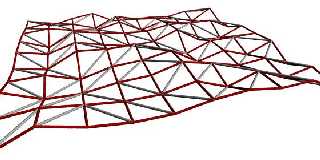

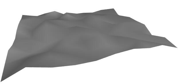

Two pictures here. The first is a wire frame showing how the different
vertices each have 2 to 8 triangles including them. The second is a picture
of the smoothed mesh.
 -Shay
Download 'Irregular_Mesh_WF.jpg' (33 KB) Download 'Irregular_Mesh.jpg' (7 KB)
Preview of image 'Irregular_Mesh_WF.jpg'
Preview of image 'Irregular_Mesh.jpg'
Wow, you did it!!  :o)  That's great!  I already had a look at the
sourcecode. It is well-documented and understandable. I like the long names
to variables. Your idea is a much better approch to the many different
states of a square (2 to 8 faces).
Now I'll try to implement it to my code. I create the faces prior to
deciding which case [/] [\] to use, so this shouldn't happen twice. The
output should be mesh2, but I think I'll easily solve these things.. I'll be
back after a closer look..
I have a working code now, it can't go fully wrong!  :o)
*Thanks!*
Hugo

I have checked your source and found comment:
        // normalize the sums of the triangle normals
        // for each vertex to get the normal for the vertex
So I assume you use simple averaging of normals.
You can consider weighted averaging - look into my post at
http://news.povray.org/3a30d5ac%40news.povray.org

Glad it helped. As far as converting to #mesh2. The vertices and normals are
already in arrays, so there will not be any problem writing it out as
#mesh2. I used #mesh because it is easier for another person to read.
I'm looking forward to using your final macro. I experimented last night
with dividing all of the squares with one or the other case, and it does
make a very big difference.
 -Shay
The weighted normals look better. Is this the case with every mesh? This
goes against everything I have seen concerning mesh normals.
By a weighted average, do you mean simply not normalizing the normal of each
triangle?
 -Shay
From:
Subject: Re: For Hugo. Irregular mesh smoothing idea.
Date: 5 Mar 2002 10:21:37
Message: <k7o98ugqa229jtfbhpkniat3g83n791lnt@4ax.com>
This is just more accurate method of averaging.
> This goes against everything I have seen concerning mesh normals.
Not exactly. Weighting is just longer and result is visible when there are
differences in triangle area.
> triangle?
Considering you have N triangles with vertex P:
- take all N normals as previously
- normalize them as previously
- new step: multiply/adjust according to area of triangle
- add all N normals as previously
- normalize this sum as previously (I'm not sure it is necessary)
So only new thing is muliplying. This is done to save larger triangles more
float.
ABX
