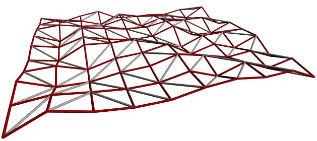

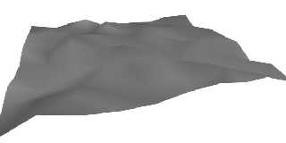

Two pictures here. The first is a wire frame showing how the different
vertices each have 2 to 8 triangles including them. The second is a picture
of the smoothed mesh.
 -Shay
Download 'Irregular_Mesh_WF.jpg' (33 KB) Download 'Irregular_Mesh.jpg' (7 KB)
Preview of image 'Irregular_Mesh_WF.jpg'
Preview of image 'Irregular_Mesh.jpg'

Wow, you did it!!  :o)  That's great!  I already had a look at the
sourcecode. It is well-documented and understandable. I like the long names
to variables. Your idea is a much better approch to the many different
states of a square (2 to 8 faces).
Now I'll try to implement it to my code. I create the faces prior to
deciding which case [/] [\] to use, so this shouldn't happen twice. The
output should be mesh2, but I think I'll easily solve these things.. I'll be
back after a closer look..
