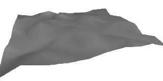

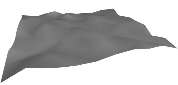

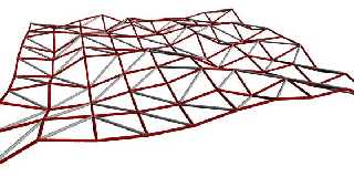

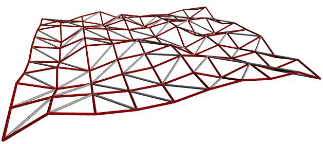

Two pictures here. The first is a wire frame showing how the different
vertices each have 2 to 8 triangles including them. The second is a picture
of the smoothed mesh.

Wow, you did it!!  :o)  That's great!  I already had a look at the
sourcecode. It is well-documented and understandable. I like the long names
to variables. Your idea is a much better approch to the many different
states of a square (2 to 8 faces).
Now I'll try to implement it to my code. I create the faces prior to
deciding which case [/] [\] to use, so this shouldn't happen twice. The
output should be mesh2, but I think I'll easily solve these things.. I'll be
back after a closer look..

I have checked your source and found comment:
        // normalize the sums of the triangle normals
        // for each vertex to get the normal for the vertex
So I assume you use simple averaging of normals.
You can consider weighted averaging - look into my post at
http://news.povray.org/3a30d5ac%40news.povray.org

Glad it helped. As far as converting to #mesh2. The vertices and normals are
already in arrays, so there will not be any problem writing it out as
#mesh2. I used #mesh because it is easier for another person to read.
I'm looking forward to using your final macro. I experimented last night
with dividing all of the squares with one or the other case, and it does
make a very big difference.
 -Shay
