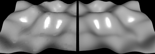

How does POV-Ray smooth height_fields?  The results aren't really good in
any case.
At the left is an ordinary smoothed height_field, at the right the same
shape using smooth_triangles.
Wouldn't it be possible to use a better way of smoothing height_fields?  As
it is now, the smooth-keyword in height_fields isn't really useful...
cu!
ZK AKA SaD
http://www.povplace.be.tf
"You know what they say: No good deed goes unpunished."

From: Hugo
Subject: Re: smooth height_fields
Date: 2 Mar 2002 12:03:33
Message: <3c8105e5@news.povray.org>
I'm surprised the left result is so bad. But how did you make the right one?
Probably the difference is that more normals are averaged.
> any case.
I can't say for sure of course, but those two shapes really don't seem to
have the same geometry to me.

From: Zeger Knaepen
Date: 2 Mar 2002 13:04:54
Message: <3c811446$1@news.povray.org>
so am I...
2 while loops.  The first one calculates a matrix of locations based on the
bozo-pattern, which is then used in the second loop to place triangles and
calculate normals.
maybe, but it almost looks like it just runs a smooth-filter on the final
image.  You can still see the edges of the triangles, but they're blurry.
Actually an interesting effect, but rather useless imho.
> Believe me, they have :)
> They're both the bozo-pattern on the xz-plane from x=0 to 1 and z=0 to 1.
That's not what i meant, the triangle vertices need to be the same for
comparable results.

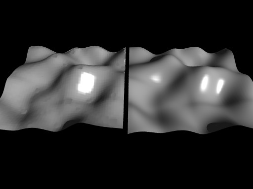

From: Zeger Knaepen
Date: 2 Mar 2002 13:09:18
Message: <3c81154e@news.povray.org>
> comparable results.
Maybe it's easier to compare this way: I mirrored one of them and moved the
light.
cu!
ZK AKA SaD
> > comparable results.
> light.
This obviously does not change anything, to really judge whether the
heightfield smoothing is broken would require perfectly identical
geometry.
