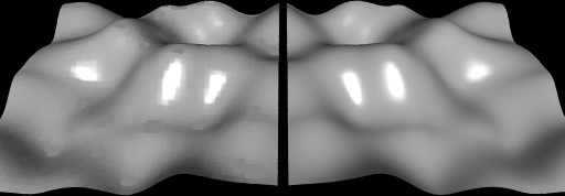

How does POV-Ray smooth height_fields?  The results aren't really good in
any case.
At the left is an ordinary smoothed height_field, at the right the same
shape using smooth_triangles.
Wouldn't it be possible to use a better way of smoothing height_fields?  As
it is now, the smooth-keyword in height_fields isn't really useful...
cu!
ZK AKA SaD
http://www.povplace.be.tf
"You know what they say: No good deed goes unpunished."
Download 'heightfield.jpg' (16 KB)
Preview of image 'heightfield.jpg'
I'm surprised the left result is so bad. But how did you make the right one?
Probably the difference is that more normals are averaged.

I can't say for sure of course, but those two shapes really don't seem to
have the same geometry to me.
Believe me, they have :)
They're both the bozo-pattern on the xz-plane from x=0 to 1 and z=0 to 1.
cu!
ZK AKA SaD
so am I...
2 while loops.  The first one calculates a matrix of locations based on the
bozo-pattern, which is then used in the second loop to place triangles and
calculate normals.
maybe, but it almost looks like it just runs a smooth-filter on the final
image.  You can still see the edges of the triangles, but they're blurry.
Actually an interesting effect, but rather useless imho.
That's not what i meant, the triangle vertices need to be the same for
comparable results.
Last updated 21 Feb. 2002 _____./\/^>_*_<^\/\.______

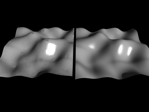

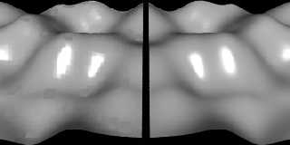

> comparable results.
Maybe it's easier to compare this way: I mirrored one of them and moved the
light.
cu!
ZK AKA SaD
"we will make spears twice as long as a man, but some men are longer than
others"
Download 'heightfield2.jpg' (15 KB)
Preview of image 'heightfield2.jpg'
> > comparable results.
> light.
This obviously does not change anything, to really judge whether the
heightfield smoothing is broken would require perfectly identical
geometry.
