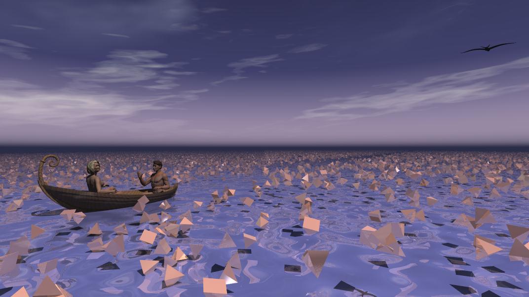

Hi
A few days ago I saw this link in povray.off-topic
http://www.henrywagner.org/povray/images/field1.htm and decided to re-create
the scene.
I got a fair-ish representation last week and added the poser people and the
boat today.
Although I have a question about what pov does during the parse stage.
During test renders I was using ~30,000 objects (pyramid2 from shapes.inc)
for which the total trace time was just a few minutes. For the final render
I used ~60,000 of these objects and even though the trace only took a few
minutes, pov took 25 minutes to during the parse to create light and vista
buffers. Is there anything I can do to speed this process up? I changed the
union to a mesh in the pyramid2 definition and that helped loads - peak
memory used dropped from 50Mb to about 14Mb in the 30K object case - but on
the final render peak memory was 125Mb and my machine has only 64Mb so
windows was thrashing the virtual mem a bit. (maybe I just answered my own
question)
Thanks
Jim
Download 'Field_new.jpg' (77 KB)
Preview of image 'Field_new.jpg'

My gosh! Look at the pollution!
=) jk, I like it, though it seems a bit simple - a big island in the
distance may add something.
did you intend for the shapes to be floating? 'cause they're hovering in the
air at the moment.
- Slime
[ http://www.slimeland.com/ ]
[ http://www.slimeland.com/images/ ]
I think this may be my over entusiastic first attempt at using the fog, but
it is however nesecary to 'cover up' the fact that there are only a finite
number of the shapes which extend only a couple of hundred units into the
distance...i'll tweak the fog colour a little
I did think that in some form it would serve as a nice background to my
currently backgroundless IRTC effort. and seeing as there's only 5 days left
it probably will have to do, although when I pull them together I'm hoping
it won't look like two scenes that are just 'glued' together.
the
> air at the moment.
The shapes are floating yes, like in the original
image(http://www.henrywagner.org/povray/images/field1.htm) although now you
mention it, a nice addition may be to make an isosurface ocean (or similar
object with actual waves) and use trace() to place the shapes on the waves.
(a bit too advanced for me at the moment perhaps)
Jim

Hi! I liked your image with all the stuff floating over the water! You've just
inspired me and gave me new ideas! Thanks!
jimbobjim wrote:
> Hi
> the scene.
> boat today.
> question)
You're saying you got not enough memory? I can't stand it that technical
problems stop others from working with povray. I'll get you additional 64Mb or
128Mb memory RAM as a favor from a friend! I need to know what memory type do
you want (SDRam or the newer one)
> Thanks
> Jim
Well done!! Keep up the good work!
