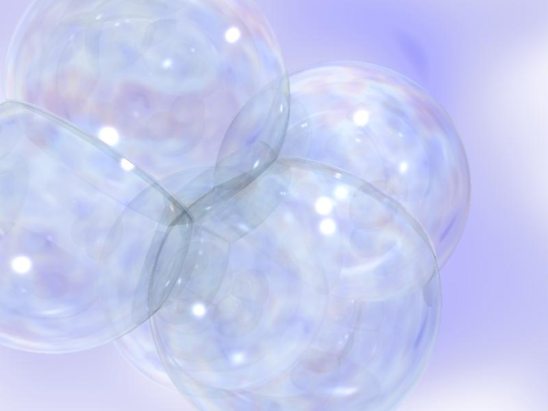

Hi,
I've been playing with some macros for generating bubble
CSG objects, the aim being to create a disk where two
bubbles meet, rather than simply two intersecting
spheres. It even seems to be working (though the macros
are still a bit sloppy) as you should be able to see
if you look closely at the parts where the bubbles intersect.
The macros take an array of bubble centers and radii as input,
and should work even for large numbers of bubbles (but rendering
will probably slow down a bit ;-)
I benefitted greatly by advice I read on this news server,
about making CSG differences more efficient, to the tune of
about a 1000% (literally!!) improvement in render time,
so thanks for that, whoever you were! :-)
This 800x600 image took about 1hr to render on my K6-3 450
w/ 250M with +A0.3 and +AM2 (but about 150M free, and I was
continuously browsing the web while it ran.)
(I can only hope my primitive binary-posting technology will
work ok on this server, since I've never tried it before.
Apologies in advance, if it doesn't pan out...)
- Pete.

From: Tim Nikias
Subject: Re: messing with bubbles (23k)
Date: 16 Feb 2002 19:51:42
Message: <3C6EFE9E.929C4C0B@gmx.de>
Thanks for making all of us a part of this!
I think it looks really nice, ever thought about making a bathtub
with foam?
Tim Nikias

From: Pete
Date: 17 Feb 2002 02:52:38
Message: <3c6f6146@news.povray.org>
Thanks! :)
> ever thought about making a bathtub with foam?
Foam would be nice, but I'm not sure how quick it would
be :-) Still, the macro doesn't seem to hang up the render
outside the bubble areas.. I think perhaps the right way
to do it might be to generate a bunch of positions and
radii which form a sort of skin over where the foam is
to be, perhaps one or two layers of bubbles, and then
put some texture beneath that (which won't really be
seen in detail anyhow, hopefully) in order to cut down
on the max_trace_level setting needed (because that
would get really high with large solid chunks of foam
made of all these transparent bubbles.)
It would be necessary to work up something to generate
the positions and radii appropriately - but that shouldn't
be too hard. One problem is that the macro (currently) fails
to construct the appropriate disc between two bubbles if the
center of one bubble falls inside the other.
Ryan Mooney wrote:
> have you or will you post the macro for public view... ???
I thought I would wait a bit until I fixed up some uglinesses,
but since that may take a while, and since I have no shame about
my bad pov-code, and since it's even possible if I post that it
someone else will make it nicer ... here it is!
As is, it requires version 3.5 (for conserve_energy in the
texture definition, and for a transform macro used at one
point, but neither of these are major problems to change.)
You'll notice I have two pretty much identical macros bubchop
and bubchop2. They started off different ...
Also, I have been too lazy to find if there's a function which
will return the length of an array, so I include that as a
parameter, which kind of smells funny, IMHO, but never mind ;-)
It expects an array definition like this
#declare TheBubbles = array[12] {
	-2.5, 1.5, 0,  3.2
	 2.5, 1.5, 0,  3.5
	 0,    -1, 0,  3.4
where each four elements are center.x, center.y, center.z, radius,
and then you call it with
     bubs(TheBubbles,12)
To change the texture, just edit or re-declare the BubTex definition.

8<-----C-U-T---H-E-R-E-----
As I've implied, it's really not finished yet, and there are
no doubt many fixes and improvements to be made... which anyone
is welcome to do (so long as they post them back to
news.povray.org! ;-)
- Pete.
