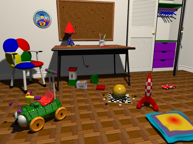

Hi all:
First of all, thank you all for your comments and replies to my previous
post on this subject. All were very helpful.
Here is take two. I have replaced the poster with a board with some pins
(the pictures will come later), added a lamp and a cushion (even though
their textures are going to change), scaled up the floor, changed the clock
texture, rotated the baby walker and the pointlight is an area light now.
I have decided to use Poser, so maybe some objects must change their
position.
As this render includes some of your suggestions, I think it's time to show
it to you.
Comments?
Bye
Txemi Jendrix
tji### [at] euskalnetnet
http://www.geocities.com/txemijendrix
Download 'supper.jpg' (176 KB)
Preview of image 'supper.jpg'

That's a really fun scene.  I think it's great.  A few things that might
help...
1.  I think the phong value on the green bug-eyed car thing is a bit too
high.  It just looks too glossy for plastic.
2.  By the color of the light source, I'd say it's a fluorescent, but by the
sharpness of the shadows (I know it's an area light, but I think it needs to
be spread out more), it looks more like the light is coming from a single
light bulb.
3.  The antialiasing is doing some funky kind of swirl pattern across your
new bulletin board.  I'm not sure how to fix that, but it looks a little
odd.
4.  I think radiosity would help your picture lots.
5.  Is your floor a repeating image map?  It would be nicer if the woodgrain
wasn't the same in each tile.  If it is an image map, a simple solution
would be to make the square tile transparent in a GIF, then put a wood
texture underneath the whole thing.  Just a thought.
Anyway, I love your modelling.  Keep working at it.
Stephen

This picture is getting nicer and nicer. I really like the design of that lamp, it's
funny.
About the lighting: are you using a fill light or ambient light? I would put the
latter in your cellar and use the former. One single shadowless fading light put at
the camera location does quite always an excellent job (of course if you're planning
to use radiosity this doesn't apply).
The lighting looks a bit too uniform now: I would use a more pronounced fading for
the main light. Also using multiple fading lights adds much to the realism: so I
would turn on that nice lamp. Some blurred reflections on that parquet would be great
too!
While designing indoor scenes I always ask to myself: does this room really lack of
windows? If the answer is no, then you have to consider that aspect too. Of course if
the scene is taken at midnight you can just forget about windows, but if not you have
to consider that windows always contribute to lighting, even in the evening (excuse
my wordplay).
Keep up the good work.
Jonathan.

Some very nice work.  I agree though that it does have the feeling as if a
single light bulb were hanging from the ceiling.  If this is the lighting
affect you are trying to achieve (like say in a basement rec room) then its
not a bad recreation.
As for the moire on the board.  I read a technique for eliminating such a
problem in a scene description of a Norbert Kern IRTC entry (Spirit of
Asia).  He rendered his scene at a much higher resolution then what he
submitted and then reduced the resolution in Photoshop, allowing the
resizing filters to compress a fine texture without the geometric patterns.
http://www.irtc.org/ftp/pub/stills/2001-12-31/chado.txt
Skip
 > position.
Good idea! People in the image would liven it up even more!
It's usually recommended to have objects face the inside of your picture
(to encourage people to look /into/ the scene.) I'd actually rotate the
baby walker around again so it's facing the inside of the scene (but
still not so much in front of the chair leg as it was before.)
I really like the bulletin board and the clock.
Maybe some subtle stains and/or smudges on the wall would make it look
more realistic.
 > woodgrain wasn't the same in each tile.  If it is an image map, a
 > simple solution would be to make the square tile transparent in a GIF,
 > then put a wood texture underneath the whole thing.
You might also be able to fix that with a clever use of warps or
material maps.
I would think some work with adaptive anti-aliasing would fix it, too.

I know this probably is not what you want to do with your scene, but a great
use for a perfectly modeled child's room would be a child standing in a
window basked in movie-cliche flying saucer light OR a monster under the bed
or in the closet OR a child genius building a doomsday device in the closet.
 -Shay
Thank you very much.
> help...
Well, it's a specular value, but I think reflection contributes to the
effect. It's something that must be adjusted (the baby walker looks like it
has been bought an hour ago) and that I have in my to-do list.
the
to
> light bulb.
Yes, the area light is 'compressed' in a little space to look like as if
came from a single light blub. When I've tried to scale it up, the shadows
were all wrong. I have to try the light macro made by Jaime Vives to see
what happens (I'm too busy on modelling and texturing right now).
> odd.
It has to do with the resolution. If I render the picture bigger it
disappears. In the final render that will be fixed.
I think so, but I don't know if I'll have time enough to test it (if not for
the IRTC, sure that I will try in the future).
Yes, the floor is a repeating image map done in Photoshop. I'm trying to get
a decent carpet now so most of the floor will not be seen.
Thank you again, and thank you for your comments.
Bye
Txemi Jendrix
From: Txemi Jendrix
Subject: Re: WIP WwW 2 (175 Kb)
Date: 6 Feb 2002 19:15:05
Message: <3c61c709@news.povray.org>
news:3c5d09e6$1@news.povray.org...
its
Thank you first. Secondly, yes, the effect I'm trying to achieve is the one
made by a single light blub. I have not seen a kids's room wit a fluorescent
in all of my life (perhaps is a spanish way ;-)
patterns.
I now the technique, but if I render it a little bit big, the moire on the
board disappears (as the moire in some clothes I have made for the
cupboard).
Thank you for your comments
Bye
Txemi Jendrix
