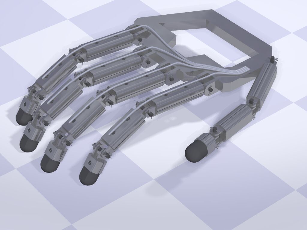

Here it is - my very first object that I'll publicly admit to creating.
Every day on the train home for about 30 minutes and then every evening that
my wife lets me has resulted in this...
The whole thing was created using CSG for the fingers, prisms for the hand
and the fabulous Splines.inc by Chris Colefax.  I'm struggling a bit with
creating interesting textures, but am pleased that I manged to get the
fingers controllable by a simple macro:
#macro Finger(FingerType, Bend1, Bend2, Bend3)
Is that FK? I tried IK (I think) but could work out the angles needed for a
specified point at the tip.  :(
I suppose next comes the
wrist...arm...shoulder...torso...don'tforgettoeat...legs...feet...divorce...
head...
Mark Hanford

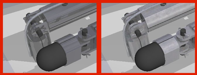

What do you think about this texture as main texture? (just a quick
metaltexture I just made)
 texture {
  average
  texture_map {
   #declare Seed=seed(56);
   #declare Samples=20;
   #declare I=0;
   #while (I<Samples)
    [1
    pigment {
     average
     pigment_map {
      [1
      crackle solid
      color_map {
       [0 rgb <.9,.95,1>]
       [1 rgb <.8,.85,.9>/2]
      scale .25
      [1
      granite scale .5
      color_map {
       [0 rgb <.5,.4,.3>]
       [1 rgb <1,.9,.8>]
    normal {
     granite .5
     rotate z*45
     translate rand(Seed)
     scale 10000
    finish {
     ambient 0
     diffuse .8 brilliance 5
     specular 1 roughness .01 metallic
     irid {
      .2
      thickness .5
      turbulence 1
     reflection .5 reflect_metallic
    #declare I=I+1;
   #end
(You might need to change some things if you want to use this for POV-Ray
3.5)
Oh yeah, one remark: it seems like your thumb can't do all the motions a
human thumb can.  Am I right?

wow...
the thumb needs a way to be opposable... It needs a  joint at the base for
vertical movement like the fingers... =]
Also the fingers need slight horizontal movement but that looks complicated
with the design you have... Oh and don't forget to be extra versatile with the
better half... =] Yours that is... =] TTFN

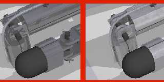

Thanks, the pps with Samples=20 is about 9, and that's without AA or Rad!
I've changed the Samples to 5 and here's the result.  I like it :)
Here's a small sample render - I like the mottled effect.  Still took 15
minutes :(

I don't know yet if the "die-cast" type effect for the hand's frame is
right, or if it needs to me made up of parts like the fingers.  It was
really just something to hold the fingers together.
The thumb is something I've been trying to ignore really.  I had trouble
making it move in all the required directions and also making the main body
of the hand be the right shape to hold it.  I can't quite work out how I'm
going to do it with the style I've picked - I'll probably have to dig out my
old Lego Technic and try it for "real".  (Maybe Fred Breizatao or Anton
Rave's Lego POV kits would be more fitting :)
I don't suppose this hand will ever do a Vulcan salute with fingers like
that.
Mark
that
hand
a
> head...
> Mark Hanford
Well, when you're going through with this and start animating the whole
thing, I could perhaps lend you my phoney Austrian accent to have it say
"I'll be back!"
Looks good!
