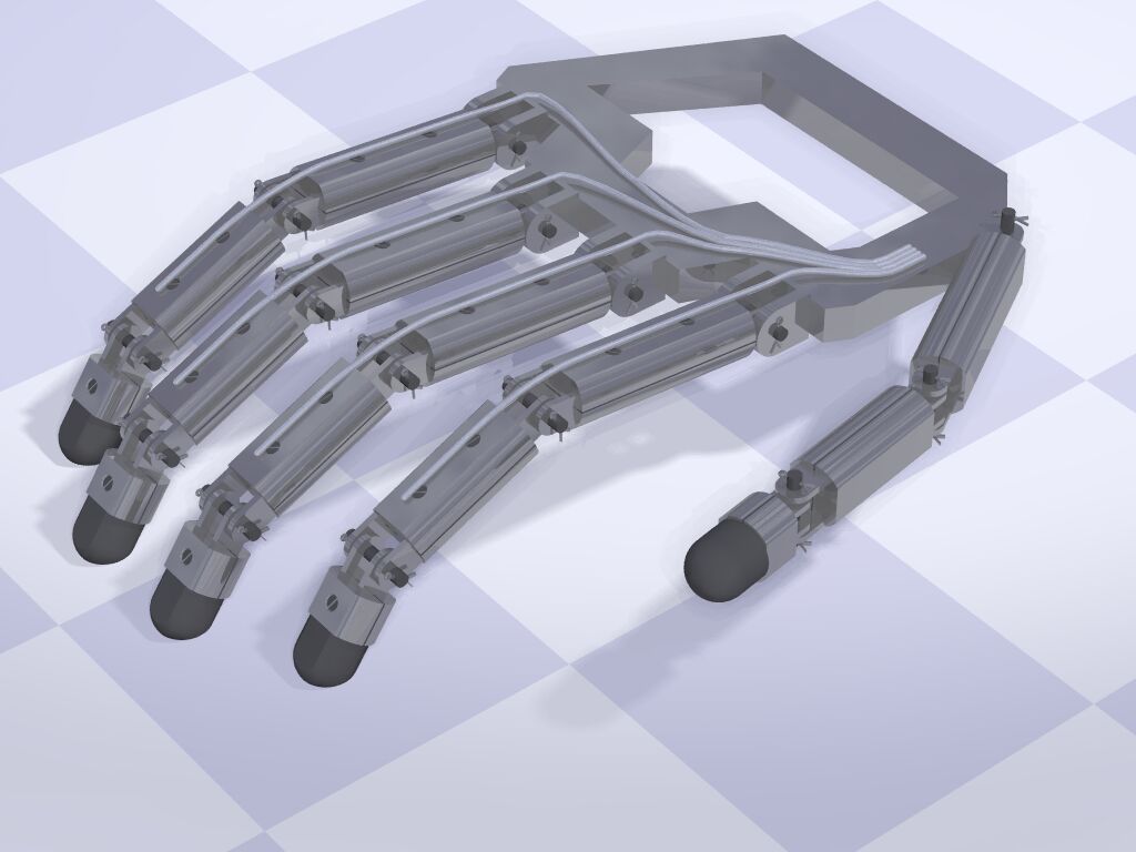

Here it is - my very first object that I'll publicly admit to creating.
Every day on the train home for about 30 minutes and then every evening that
my wife lets me has resulted in this...
The whole thing was created using CSG for the fingers, prisms for the hand
and the fabulous Splines.inc by Chris Colefax.  I'm struggling a bit with
creating interesting textures, but am pleased that I manged to get the
fingers controllable by a simple macro:
#macro Finger(FingerType, Bend1, Bend2, Bend3)
Is that FK? I tried IK (I think) but could work out the angles needed for a
specified point at the tip.  :(
I suppose next comes the
wrist...arm...shoulder...torso...don'tforgettoeat...legs...feet...divorce...
head...
Mark Hanford
Download 'Hand.jpg' (63 KB)
Preview of image 'Hand.jpg'
From: Zeger Knaepen
Subject: Re: Robot Hand WIP
Date: 18 Jan 2002 18:40:03
Message: <3c48b253@news.povray.org>
Looks good!
What do you think about this texture as main texture? (just a quick
metaltexture I just made)

(You might need to change some things if you want to use this for POV-Ray
3.5)
Oh yeah, one remark: it seems like your thumb can't do all the motions a
human thumb can.  Am I right?
cu!
ZK AKA SaD
http://www.povplace.be.tf
"I've never understood why it should be necessary to become irrational in
order to prove that you care... Or why it should be necessary to prove it at
all."
From: Ryan Mooney
Date: 18 Jan 2002 19:58:38
Message: <3C48C4BE.1A3FD885@earthlink.net>
wow...
the thumb needs a way to be opposable... It needs a  joint at the base for
vertical movement like the fingers... =]
Also the fingers need slight horizontal movement but that looks complicated
with the design you have... Oh and don't forget to be extra versatile with the
better half... =] Yours that is... =] TTFN

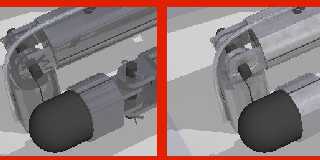

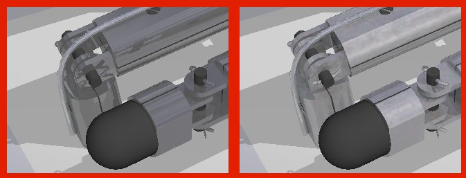

From: Mark Hanford
Subject: Re: Robot Hand WIP (50k JPG)
Date: 19 Jan 2002 14:25:27
Message: <3c49c827@news.povray.org>
Thanks, the pps with Samples=20 is about 9, and that's without AA or Rad!
I've changed the Samples to 5 and here's the result.  I like it :)
Here's a small sample render - I like the mottled effect.  Still took 15
minutes :(
"Zeger Knaepen" <zeg### [at] studentkuleuvenacbe> wrote in message
news:3c48b253@news.povray.org...
> Looks good!
>  texture {
>   average
>   texture_map {
>    #declare Seed=seed(56);
>    #declare Samples=20;
>    #declare I=0;
>    #while (I<Samples)
>     [1
>     pigment {
>      average
>      pigment_map {
>       [1
>       crackle solid
>       color_map {
>        [0 rgb <.9,.95,1>]
>        [1 rgb <.8,.85,.9>/2]
>       scale .25
>       [1
>       granite scale .5
>       color_map {
>        [0 rgb <.5,.4,.3>]
>        [1 rgb <1,.9,.8>]
>     normal {
>      granite .5
>      rotate z*45
>      translate rand(Seed)
>      scale 10000
>     finish {
>      ambient 0
>      diffuse .8 brilliance 5
>      specular 1 roughness .01 metallic
>      irid {
>       .2
>       thickness .5
>       turbulence 1
>      reflection .5 reflect_metallic
>     #declare I=I+1;
>    #end
> 3.5)
> cu!
> ZK AKA SaD
at
> all."
Download 'hand.jpg' (33 KB)
Preview of image 'hand.jpg'
From: Mark Hanford
Date: 19 Jan 2002 16:16:58
Message: <3c49e24a@news.povray.org>
I don't know yet if the "die-cast" type effect for the hand's frame is
right, or if it needs to me made up of parts like the fingers.  It was
really just something to hold the fingers together.
The thumb is something I've been trying to ignore really.  I had trouble
making it move in all the required directions and also making the main body
of the hand be the right shape to hold it.  I can't quite work out how I'm
going to do it with the style I've picked - I'll probably have to dig out my
old Lego Technic and try it for "real".  (Maybe Fred Breizatao or Anton
Rave's Lego POV kits would be more fitting :)
I don't suppose this hand will ever do a Vulcan salute with fingers like
that.
Mark
that
hand
a
> head...
> Mark Hanford
