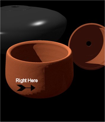

I've been seeing some strange artifacts in the shadows of some rot-sweep
objects that I've been rendering.  I'm new to this so forgive me if the
answer is obvious - but I can't seem to figure out what's causing it.
All objects are visible.
 Any suggestions would be greatly appreciated!
Jim
Download 'jaggie bowls.jpg' (16 KB)
Preview of image 'jaggie bowls.jpg'

Try giving your pot a finish with a tiny bit of shinyness in it.

Read section 9.8 in the 3.5 docs (I don't know if it is in the 3.1 docs).  I
thionk this is what you are seeing.

Looks like a mesh and not a lathe, for meshes this is quite natural.
See:
http://www.povray.org/working-docs/id000359.html

If the object consist of triangles (i.e. is a mesh) this is natural but
otherwise not. You found a really strong example.
The problem can be much reduced with area_lights because they cast smooth
shadows.
Hugo

I had this problem once, increasing the divisions and export divisions fixed
it quite a bit - made it less noticable anyway

If I'm not mistaken, there is an optional keyword for using a more precise
algorithm for lathes. It was something like STURM, but I haven't seen the
manual... maybe I'm wrong.
I hope it helps you,
Fernando.

I found that the object was actually a RAW object which is generated by
moray for rotations using a Glyph.  Changing to cubic spline in Moray has
made a big difference.  Now...to figure out why.
Jim

Moray attempts to export POV-Ray primitives (lathe, prism) for the
sweeps whenever possible, if not, it exports (smooth) triangles. If
you use the glyph sweep type it cannot export to a POV primitive since
glyph is not a POV-Ray spline type.
