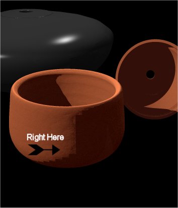

Hi,
I've been seeing some strange artifacts in the shadows of some rot-sweep
objects that I've been rendering.  I'm new to this so forgive me if the
answer is obvious - but I can't seem to figure out what's causing it.
All objects are visible.
 Any suggestions would be greatly appreciated!
Jim

Try giving your pot a finish with a tiny bit of shinyness in it.

Read section 9.8 in the 3.5 docs (I don't know if it is in the 3.1 docs).  I
thionk this is what you are seeing.

Looks like a mesh and not a lathe, for meshes this is quite natural.
See:
http://www.povray.org/working-docs/id000359.html

If the object consist of triangles (i.e. is a mesh) this is natural but
otherwise not. You found a really strong example.
The problem can be much reduced with area_lights because they cast smooth
shadows.

I had this problem once, increasing the divisions and export divisions fixed
it quite a bit - made it less noticable anyway

If I'm not mistaken, there is an optional keyword for using a more precise
algorithm for lathes. It was something like STURM, but I haven't seen the
manual... maybe I'm wrong.
I hope it helps you,
Fernando.

I found that the object was actually a RAW object which is generated by
moray for rotations using a Glyph.  Changing to cubic spline in Moray has
made a big difference.  Now...to figure out why.
Jim

Moray attempts to export POV-Ray primitives (lathe, prism) for the
sweeps whenever possible, if not, it exports (smooth) triangles. If
you use the glyph sweep type it cannot export to a POV primitive since
glyph is not a POV-Ray spline type.
