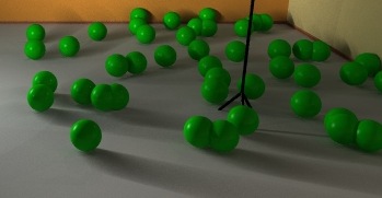

soemthing curious happened as i tried out vlength.
my aim was to put random spheres on the floor and the code itself has to
avoid intersections.
whenever i test about vlength i always get intersections between spheres.
my formular
#if ( (vlength(Mylist[Temp]-Random_Place)) > (2*Radi) )
takes no effect, whatever i put in for Radi from 0 till 0.5.
if i proof differences of Radi above 0.5 i get an error message that my
array is uninitialized.
maybe anyone can say what went wrong with the code.
attached is the scene which is everytime the same.
//----------------------------------------------code starts

Download 'vlength.jpg' (15 KB)
Preview of image 'vlength.jpg'
> my formular
I think the problem in your code is that if even at one point the vlength >
2*Radi (and the propability is quite high for that) then it doesn't matter
if at some other point the vlength < 2*Radi.
I'd correct the code for you but my brain isn't functioning properly atm :)
-Jide
>my formular
Your code looks for a random location for which there is at least one
ball that is at least (2*Radi) away. It only needs to find one such ball
to decide that the new location is OK, therefore it considers just about
everywhere to be OK.
What you ought to be looking for is a location for which *all* the balls
are at least (2*Radi) away. Like:-
  #local Good = 0;
  #while (Good = 0)
     #local Random_Place = <3*rand(ix),0,3*rand(ze)>;
     #local Temp = 0;
     #local Good = 1;
     #while (Temp < Counter)
        #if ( (vlength(Mylist[Temp]-Random_Place)) < (2*Radi) )
            #local Good = 0;
        #end
        #local Temp = Temp + 1;
     #end //while(Temp..
  #end //while(Good=0)
You now have to keep Radi below about 0.17 or there won't be anywhere
left to place the 50th ball, and the code will loop forever.
Mike Williams

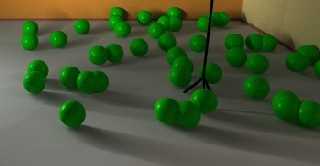

> -Jide
Ok ok. Couldn't resist. Hope outlook won't screw up the wrapping.
Oh and btw. If at some point it parses WAY too long then lower
NumBalls or increase the possible area of Random_Place (ie.
<5*rand(Seed),0,5*rand(Seed)>.
#local NumBalls = 100;
#local Counter = 1;
#local Seed = seed(4);
#local Mylist = array[NumBalls]
#local Mylist[0]= <3*rand(Seed),0,3*rand(Seed)>;
#local Radi = 0.1;      //takes no effect from 0 till 0.5 and above
#while (Counter < NumBalls)
  #local Good = 1; //Assume there is no intersection
  #local Random_Place = <3*rand(Seed),0,3*rand(Seed)>;
  #local Temp = 0;
      #local Good = 0;
        //But if even 1 intersection is found then reject the random point
    #end
    #local Temp=Temp+1;
  #end //while (Temp <= Counter)
  #if(Good)
    #local Mylist[Counter] = Random_Place;
    sphere {
      <0,0,0>,Radi
      pigment{color Green}
      translate y*Radi
      translate Mylist[Counter]
    #local Counter=Counter+1;
  #end  //if (Good)
#end //while
//----------------------------------------------code ends
-Jide

From: marabou
Subject: Re: vlength [14.7kb]
Date: 5 Jan 2002 10:25:14
Message: <3c371ada@news.povray.org>
okay, you inverted my look of this. with your code you get an endless loop.
i do not know, but it has to do with the line
Mike Williams wrote:
>   #local Good = 0;
>   #while (Good = 0)
>      #local Temp = 0;
>      #local Good = 1;
>             #local Good = 0;
>         #end
>      #end //while(Temp..
From: marabou
Date: 5 Jan 2002 10:36:54
Message: <3c371d95@news.povray.org>
your code works really fine! seems as i code too complicated...
