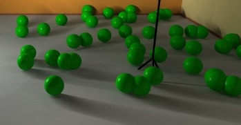

soemthing curious happened as i tried out vlength.
my aim was to put random spheres on the floor and the code itself has to
avoid intersections.
whenever i test about vlength i always get intersections between spheres.
my formular
#if ( (vlength(Mylist[Temp]-Random_Place)) > (2*Radi) )
takes no effect, whatever i put in for Radi from 0 till 0.5.
if i proof differences of Radi above 0.5 i get an error message that my
array is uninitialized.
maybe anyone can say what went wrong with the code.
attached is the scene which is everytime the same.

Download 'vlength.jpg' (15 KB)
Preview of image 'vlength.jpg'

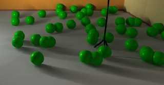

From: marabou
Subject: Re: vlength [14.7kb]
Date: 5 Jan 2002 10:25:14
Message: <3c371ada@news.povray.org>
okay, you inverted my look of this. with your code you get an endless loop.
i do not know, but it has to do with the line
