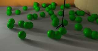

soemthing curious happened as i tried out vlength.
my aim was to put random spheres on the floor and the code itself has to
avoid intersections.
whenever i test about vlength i always get intersections between spheres.
my formular
#if ( (vlength(Mylist[Temp]-Random_Place)) > (2*Radi) )
takes no effect, whatever i put in for Radi from 0 till 0.5.
if i proof differences of Radi above 0.5 i get an error message that my
array is uninitialized.
maybe anyone can say what went wrong with the code.
attached is the scene which is everytime the same.
//----------------------------------------------code starts

Download 'vlength.jpg' (15 KB)
Preview of image 'vlength.jpg'

From: marabou
Subject: Re: vlength [14.7kb]
Date: 5 Jan 2002 10:25:14
Message: <3c371ada@news.povray.org>
okay, you inverted my look of this. with your code you get an endless loop.
i do not know, but it has to do with the line
      #while (Temp < Counter)

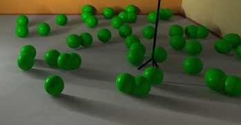

From: marabou
Date: 5 Jan 2002 10:36:54
Message: <3c371d95@news.povray.org>
your code works really fine! seems as i code too complicated...
