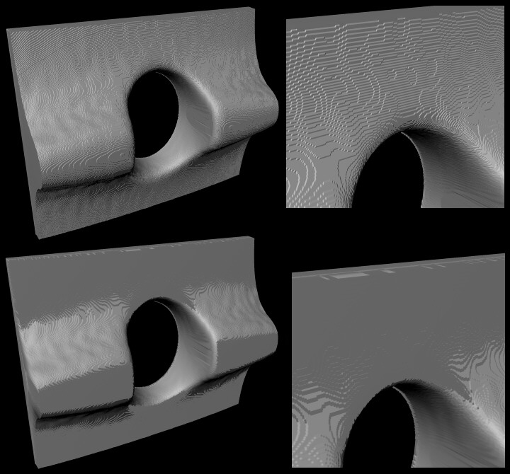

Hello,
The attached picture show heightfields created from an isosurface. The
bottom ones are "smooth" but don't exactly look like I would expect, or like
I remember triangles do when they are smoothed correctly.. I tried different
lights.. I tried TGA, PNG and GIF.. I tried POV 3.5, MegaPOV 0.7 and POV
3.1g and two computers.. It's all the same..What do you think?
#version 3.5;
camera { right -1.33*x up 1*y direction 1*z
 location <-3.5,3.2,6>*.6 look_at 0 angle 48 }
light_source { <-25,25,25> color rgb 1 }
height_field { png "heightfield.png"
 water_level .000001 translate -.5
 scale <3,.75,2.75> rotate 90*x
 pigment { rgb 1 }
 finish { ambient 0 diffuse .67 specular .1 }
 no_shadow }
Download 'Problem_Heightfield.JPG' (89 KB)
Preview of image 'Problem_Heightfield.JPG'

Hugo wrote:
> Hello,
That looks much like the heightfield having only 8 bit resolution.  Using
'hf_gray_16 on' in global_settings should help if you generate the
heightfield with Povray.  But be careful when using png output in Povray
3.5 with this since it does not work correctly right now.

Hi,
Thanks for the suggestion. I figured out myself that the 8 bit resolution
was the problem. However, wouldn't it be possible to make an "interpolate"
feature that make them appear as smooth as 16 bit?  For the user, it would
be easier to stick with 8 bit bitmaps because many paintprograms don't
support 16 bit greys.. I don't have one, that do.

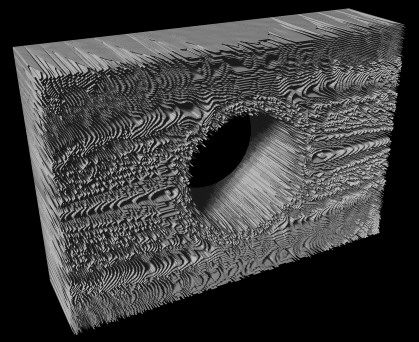

I tried to output a PNG 16 bit, and put "hf_gray_16" in global settings.. I
used POV 3.5 beta 5 and the result looks cool, as you can see.. I tried to
render the heightfield both in MegaPOV and POV 3.5 beta5, with same result.
Hugo
Download 'Problem_Heightfield2.JPG' (53 KB)
Preview of image 'Problem_Heightfield2.JPG'
