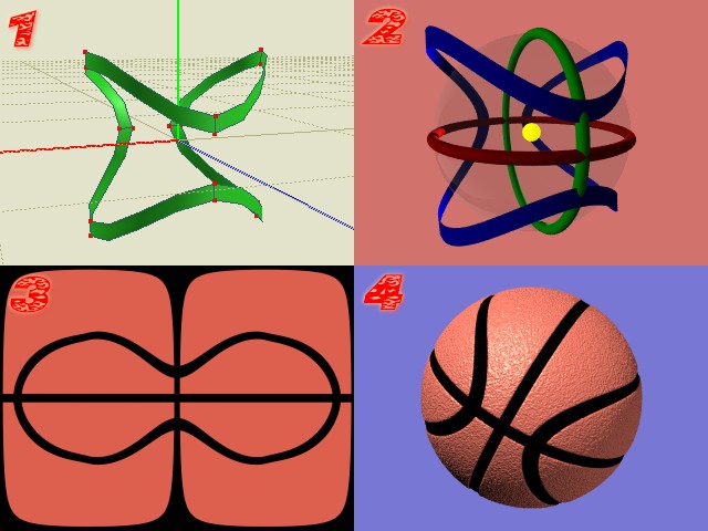

Hello, all.
This is a follow up to my post in povray.general.
I'm doing a basketball based image at the moment, and decided to make the
basketball using an isosurface.  However, coming up with a suitable
image/bump map which could be spherically mapped onto the isosurface proved
a real pain.  The maps I created in Paint Shop Pro never turned out right.
So, after a think, I decided to create the image/bump map using MegaPOV's
spherical camera - what better way to create a spherical map?
Please see the attached pic for what I'm referring to in this bit.
I had to imagine myself in the middle of a basketball (as you do).  What
would cause the pattern that I'd see?  Well, two torii going around me
should take care of the 'up and down' and 'left to right' lines, but the
awkward squiggly bit would take more work...
So, I created a patch model in Hamapatch (1) to simulate the squiggle.  This
was simply two points which were spun with the lathe feature and then
transformed and rotated about until I ended up with the final model.
Next, I set up a scene in MegaPOV (2) with a spherical camera - the yellow
dot - surrounded by the objects needed to create the map, the two torii and
the Hamapatch model.  There was no lights in the scene and the textures used
for the objects was black with an ambient of zero and no diffuse.  (The
funky colours in (2) are just there to show what's what.)  Then I rendered
the map (3), and finally placed it onto the isosurface basketball object as
both an image map and a bump map in the isosurface's function (with a bit of
noise3d thrown in).  The resulting object is shown in (4).
What d'ya think?
I'll post the image it's going in when it's completed.
Bye,
Alan.
ICQ 114025688
Black & White?
Download 'Making A Basketball.jpg' (67 KB)
Preview of image 'Making A Basketball.jpg'

Nice technique! Though I would say that it looks more like an orange tennis
ball than a basketball. I would make the black stripes much smaller for a
basketball.

Nice, but have you tried using a simple map constant in one direction and
containing a cross and two torii?  For the texture you could use the
object pattern, for an isosurface function this does not work of course.
From: Alan Holding
Subject: Re: Making A Basketball (70kbu)
Date: 12 Jul 2001 08:40:08
Message: <3b4d9aa8@news.povray.org>
Don't quite follow you there, Christoph.  What do you mean by a simple map
constant?
Thanks.

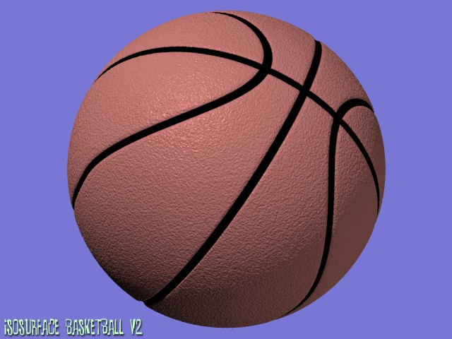

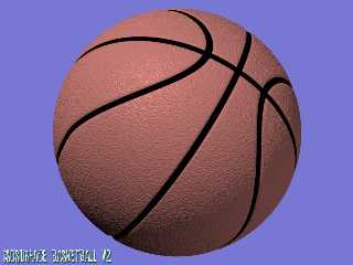

This one any better?  I've tried to improve the texture and the lines are
thinner (thanks, Thomas).  As I've (i) never played basketball in my life
and (ii) only had to go off teeny weeny pictures from online sports stores
for reference, I think this is OK now.
The ZIP archive for the scene is in povray.binaries.scene-files.
Thanks for all your feedback, chaps!  Much appreciated. :O)

From: Wolfgang Manousek
Subject: Re: Basketball v2 (62kbu)
Date: 12 Jul 2001 11:42:35
Message: <3b4dc56b$1@news.povray.org>
very nice, take another 10% or 20% off the dark lines.
a standard baseketball is a little bit more on the 'red' side, and I think
the surface is more rough (the bumps are much more noticable and kind of
roundish), the surface is also not as reflective
a more expensive leather basketball is more 'brown' and not as reflective,
the surface would work fine.
Thanks for the great explanation in you original mail !
Date: 12 Jul 2001 13:14:15
Message: <3B4DDB6D.CDDDFD83@gmx.de>
> constant?
Just try an image map without special cylindrical mapping etc.  The used
image should contain a cross and two circles with the same radius as the
ball on one 'bar' of the cross each sqrt(2)*radius away from the center.
Not tested BTW so i could be wrong.
You can also do the same with the object pattern and cylinders/boxes, but
for the isosurface this won't work.
