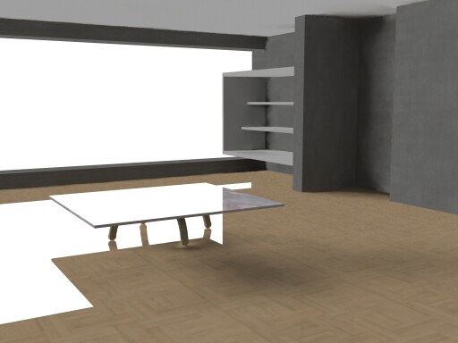

From: gemelli david
Subject: Re: Directional radiosity
Date: 9 Jul 2001 03:52:32
Message: <3B4962F6.5080806@xlstudio.com>
here is a scene I did. No light. The trick to have this "shadows" is to
put a very high ambient object to cast the "light"...here, the window is
a white box with ambient set to 100.
It's the technic I use to produce radiosity lights...It's working quite
good even if you need to do a very high count. To get the effect you
want, you can add a real light with a small intensity (rgb 0.25 or less)
to help the radiosity process and get a better result with less render time.
      David
Download 'appart.jpg' (23 KB)
Preview of image 'appart.jpg'
From: Ross Litscher
Date: 9 Jul 2001 16:03:47
Message: <3b4a0e23@news.povray.org>
I'd have to say that the white on the floor and table looks especially odd.
Instead of being white, they would just be more illuminated.
From: Thomas Lake
Date: 9 Jul 2001 19:30:14
Message: <3b4a3e86$1@news.povray.org>
No actually on a bright day that's quite accurate, perhaps if the "light
box" he used had a slightly yellowish tint it would look more like sun,
otherwise it looks good to me.

From: Ross Litscher
Date: 11 Jul 2001 16:13:49
Message: <3b4cb37d$1@news.povray.org>
For the table maybe, depending on the finish. But a carpet? It all still
looks odd to me :)
Thomas Lake <tla### [at] homecom> wrote in message
news:3b4a3e86$1@news.povray.org...

From: Tek
Date: 11 Jul 2001 17:58:37
Message: <3b4ccc0d@news.povray.org>
Ross Litscher <lit### [at] osuedu> wrote in message
news:3b4cb37d$1@news.povray.org...
> looks odd to me :)
It's a polished wooden floor, not a carpet. So what you see is a reflection
rather than illumination by the light. To make it look more like a real-world
highlight it should be slightly blurred, at present it looks like everything's
unrealistically perfectly smooth.
Tek
