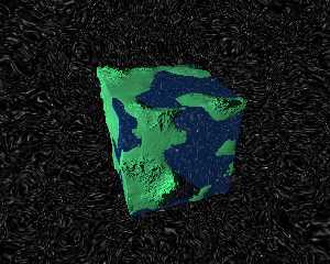

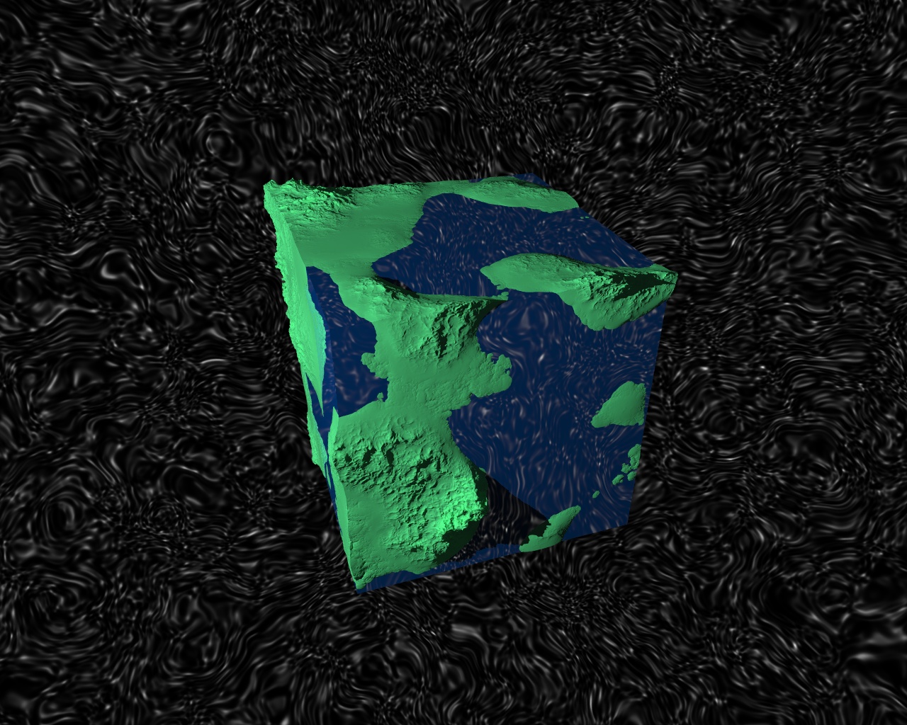

Right, what you're looking at is an isosurface (combining a box function with
ridgedmf and bozo), the sea is a cube (obviously), and the skydome is just bozo
with turbulence 100.
I'd been playing around with some ideas on how to make an isosurface planet, but
this wasn't a development of that; it was a completely new scene (I actually did
it in my lunch break at work, without access to my earlier source code). Believe
it or not I knocked it together in about half an hour! It's a complete fluke
that it ended up looking so good, but now I've got it I'm going to develop it :)
Can anyone suggest a good way to texture it? I'm tempted to do it procedurally,
but that might restrict me a bit.
Tek
http://www.evilsuperbrain.com
Download 'cubeworld.jpg' (420 KB)
Preview of image 'cubeworld.jpg'

Tek -
I would have said slope dependent texture, but somehow you'd have to
specify a different up for each face of the box and you can't use any
kind of default warp to make the normal of the box to be "up".
But wait a minute, maybe you could use slope dependent texture with the
sphere warp, then "out of the sphere" would be "up" and not only could
you make the steep mountains bald, but maybe the edges of the cube would
have a different texture, too.
Another idea.  Maybe use a "superellipsoid" type isosurface instead of a
pure box, then it is kinda a strange, twisted planet but not bizarro (
if you get the reference =)  ).
- Ben

I like it a lot - I can't say I'm a big fan of the background, but I think
the planet itself is amazing... it has so much potential - you could either
try and implement photorealistic type texturing like isosurfaced water
embedded into the box with slope-dependant texturing for the land.  Or you
could have a wacky image with a variety of colours.
One other possibility is an animation - what about a view from the ground -
with sunset etc?
Peter Cracknell
The background was just so that the sea had something to reflect. I agree that
it's ugly, I'm definitely getting rid of it :)
I'm hoping to go for a photo-realistic look. Once I've got it textured I'll try
to adapt the media sky and clouds from my last irtc entry, so it's got some
atmosphere.
> with sunset etc?
My grand scheme is to fly the camera all the way from space to the planet
surface, 'cause I don't think I've ever seen that done convincingly.
Tek

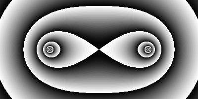

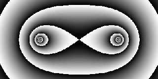

From: Anton Sherwood
Subject: Re: Cube World
Date: 24 Oct 2001 03:29:45
Message: <3BD66F38.8C76C1C6@pobox.com>
Anton Sherwood wrote:
> I'll look into it right after I work out
> how to plot the g-field of a torus!
Well, I've done the latter (approximately).
I'll get to the cube real soon now ;)
Anton Sherwood
Download 'gringi.jpg' (15 KB)
Preview of image 'gringi.jpg'
