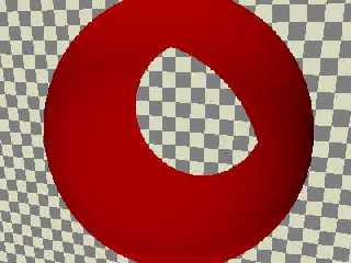

I would like to use a torus with minor radius > major radius to connect 2
cylinder  but here is the result when the minor radius > major radius.
The whole is not always visible.
Do you experimente this situation ?
Is there a way to avoid this whole ?
I post this message at ninaries images because for me it is easiest to to
explain my problem with an image

You are witnessing a bug, I believe, with the torus object in POV-Ray
version 3.1g (also MegaPOV 0.7).  What happens is that the inside/outside
becomes confused.
Bob H.

Thank you for your answer, so i have to find a way that doesn't use such a
torus.
Thank for all

For what it's worth, this bug will be fixed in 3.5.
