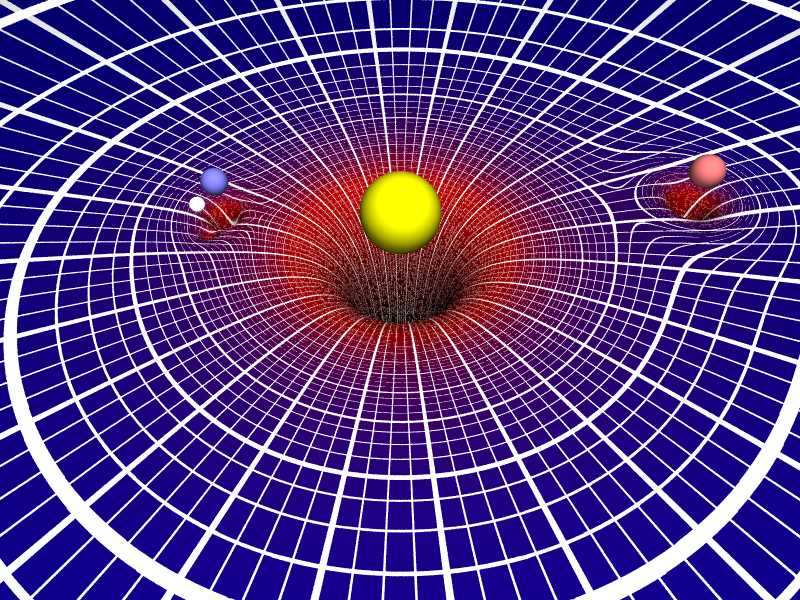

A little more detail to show the wrapping of levels around the planets.
Download 'GW04.jpg' (125 KB)
Wow, I wonder since in theory you wouldn't have any friction and decided to
throw a marble in this gravity well...  Well, I think if you'd look at it from a
camera angle like the one you currently have, it would just look like a marble
rolling from side to side, never stopping since there would be no friction,
etc...  but on the top side, as a 2D view of this, you would probably see the
marble orbiting around planets and accelerating near them and slowing down when
it's far away...
Which is very realisitic!
I wonder actually what it would like if the "planets" you got there were
orbiting around each other like a solar system and see the grid deform to show
the gravity change in space...  And throw the marble then!  What an animation it
would be!
when
> it's far away...
    That's the idea... if I had all the numbers right at least...
to
from a
marble
friction,
the
when
> it's far away...
I have seen this in real life:
In Trondheim, Norway, there's a museum called Vitensenteret (the
Knowledge-center) which have this large, about 2x2 metres, "sink" with two
holes to resemple the potential from a twin star system. Then there are som
small balls to drop, push, throw or whatever into the sink to see it move
about as a planet would in real life. This was built to demonstrate chaotic
motion, as this kind of dynamical system is chaotic. In fact, one could
easily demonstrate it by letting the ball go from the same starting point
twice and observe what path it might take.
~simenkv.
