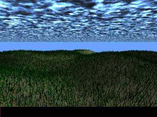

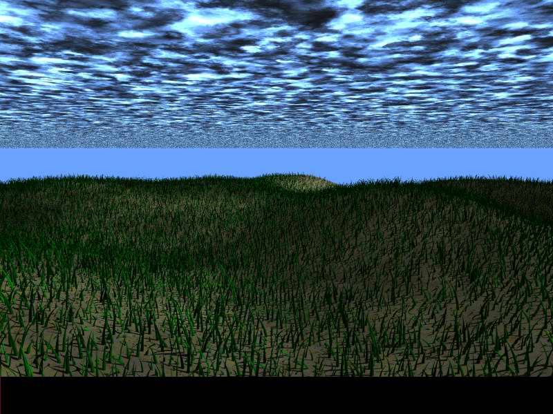

Playing around with the 'hf_height_at' function in MegaPov. I don't really
like the results, but that's because of the models I used for the grass. I
modeled 4 grass blades in Rhino and randomly chose among the 4 to place at
the various points on the hf. I don't think I'm going to work much more on
this image, it has over 69,000 objects and took over 10 hrs to render, there
is too much I would have to change and it would take too long to render. One
problem is that the way I have the script set up the blades are positioned
uniformly over he surface of the HF and despite the fact that I added random
translation there still seems to be too few blades. A good portion of the
60,000+ blades are out of view on the other side of the HF.
Download 'Grass.JPG' (84 KB)
Preview of image 'Grass.JPG'

Actually now that I take a closer look it does quite a nice job as long as
the camera is not up close, the grass at the top of the hills looks quite
realistic. Perhaps I could still use this as long as it is not up close?

Gilles Trans Make Grass macro might help out.  It allows you to define a
blade of grass from which it creates a patch of grass blades and then
make areas of grass by tiling the patches.  It will output the patch of
grass as a mesh in an include file that you can use later.
It's at http://www.oyonale.com/ressources/english/sources01.htm
Steve

Using Gilles technique I created a pic withh 33,000,000 blades of grass -
took about 2 hours to pass and 30 mins to render.
Mick

I recently had a heavy session with MP's trace and had similar
problems - low density and wasted objects. One solution was to fire
test rays from the camera at the scene and incrementing the counter
for a "hit". Haven't tried hf_height_at so don't know if trace will
work for you.
Alf
