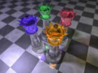

Well, here it is, after 2 days, 17 hours, 40 minutes and 34 seconds. It uses
50 samples for the focal blur, besides the photons and the heavy
max_trace_level, and the machine was being used for other things, so I think
that time is justified. This was meant to be a quick test-render for the
final version, but I think it still needs work. It doesn't look much like
the other one. Still needs a lot of tweaking. I think I'll be faking the
focal blur with a post_process, among other things. I was wondering if
anyone can tell me how you would do the pointy triangles of the crown. I
think making it out of a couple thousand (<17k) spheres in a blob {} is a
bad idea, isn't it? :\ Maybe an isosurface can do this just as well, or some
fancy CSG. We'll see. Thanks in advance for all comments and suggestions. :)
Download 'inspired_b.jpg' (8 KB)
Preview of image 'inspired_b.jpg'

"Tony[B]" wrote:
> I was wondering if anyone can tell me how you would do the pointy
> triangles of the crown. I think making it out of a couple thousand
> (<17k) spheres in a blob {} is a bad idea, isn't it? :\ Maybe an
> isosurface can do this just as well, or some fancy CSG.
Not even really fancy...
difference{
    sphere{ < 0,0,0 > 6 }
    sphere{ < 0,1,0 > 6 }
    #local i=0;
    #while( i < 360 )
        sphere{ <6,0,0> 3 rotate y*i }
        #local i=i+45;
    #end
Adjust radii and sphere locations to taste.
P.S.:  3 days for a pic this size?  Ouch!

"Tony[B]" <ben### [at] catholicorg> wrote in message
news:3b01c549@news.povray.org...
uses
think
I'd have to get out my magnifying glass to see this well enough in this
1400x1050 res. LCD.  About 2.7 days huh? Wow, were it not for the better
renders this sort of thing would be pitiful.  Sigh.
> I was wondering if
some
Well to do the queens crown what I did was to simply CSG difference spheres
from a upside-down cone, while looped in a circle of course.  The central
part was refilled with another sphere so that was covered up.  Then I added
sphere atop the points.  Works fine as seen from a distance, probably not
something to view extremely close.
Bob H.

Wow, more that 2.5 days for this tiny thing?
For the 'crown', you could of course try an isosurface, but i would
suggest a difference between a 'sphere bowl' and several vertical
cylinders.  You could also try a parabolid bowl instead of a spherical
one.

Blobs can have negative components you know.  Imagine how you'd make a circular
ashtray with CSG, a cylinder with the center taken out, and the a cylinder going
from left to right and one going from front to back, now use the same idea but
as a blob, one cylinder with all others negative, make the cut-out cylinders a
bit short so they don't go over the edge, and you get a nice smooth flowing
object.
I hope some of that made some sence.
