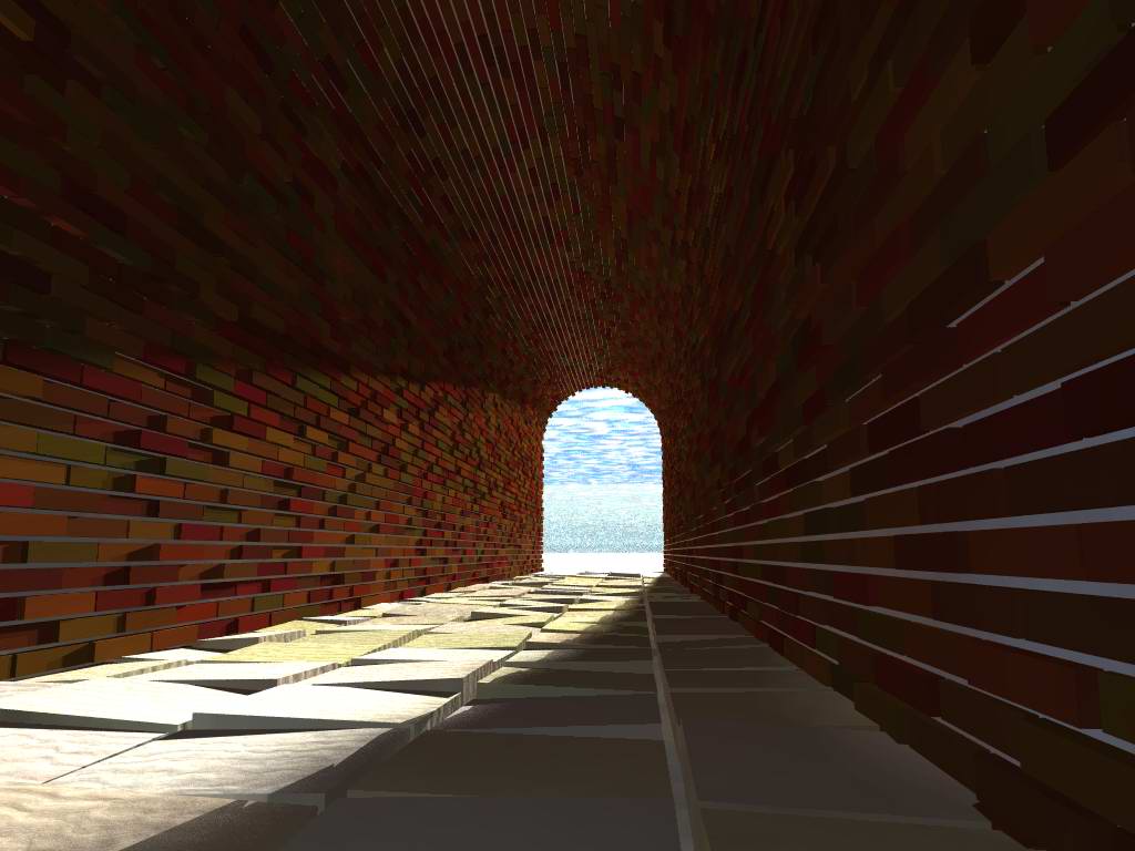

I played around with isosurfaces for the floor, but I really don't have a
good idea how they work, and also the render time would have gone through
the roof. I also tried to put some heightfield mountains in the scene but I
just couldn't get the scaling right, the end of the tunnel is 200 units away
so it makes sense to play the heightfield far away, more than 1000 units,
but I couldn't get it to look right. Despite these problems and a few others
I have made some progress. The script now automatically creates the mortar
and I have randomly rotated the floor tiles, too much perhaps. One thing I
would like to do would be to randomly add some grass/plants in the cracks on
the floor. I'm not sure quite how to do this. It would be nice if I could
have more plants near the walls of the tunnel, but to do this I would need
some form of a probability function, that would make the likelihood of a
plant appearing greater as you approached the walls. Does anyone know how I
could do this, and at the same time restrict the plants to the mortar
spaces?
I used MegaPov radiosity and an arealight here.
Download 'Tunnel 2.JPG' (68 KB)
Preview of image 'Tunnel 2.JPG'
From: Zeger Knaepen
Subject: Re: Tunnel (WIP #2)
Date: 15 May 2001 09:01:22
Message: <3b0128a2$1@news.povray.org>
I love the floor, I don't like the background, and it looks like the mortar has
an ambient-setting higher than 0...
cu!

SFSG. Maybe try a slightly rolling heightfield of mossy mud just high enough
to fill in the cracks in the lowest parts of the floor and cover the lowest
parts of the floor tiles.
The floor looks quite good IMO, the walls are a bit strange though: they
are very straight in total, but the position of the single bricks varies
extremely.  Also the mortar seems too bright in the shadow.
> One thing I
Just choose random positions and round to the nearest gap in one
direction.
> spaces?
You can achieve different propabilities by using things like:
#if(rand(Seed)<0.2)
This example would give a propability of 1/5.
Normally you would not need such constructions, because you can simply
influence the total number of plants in one section.
