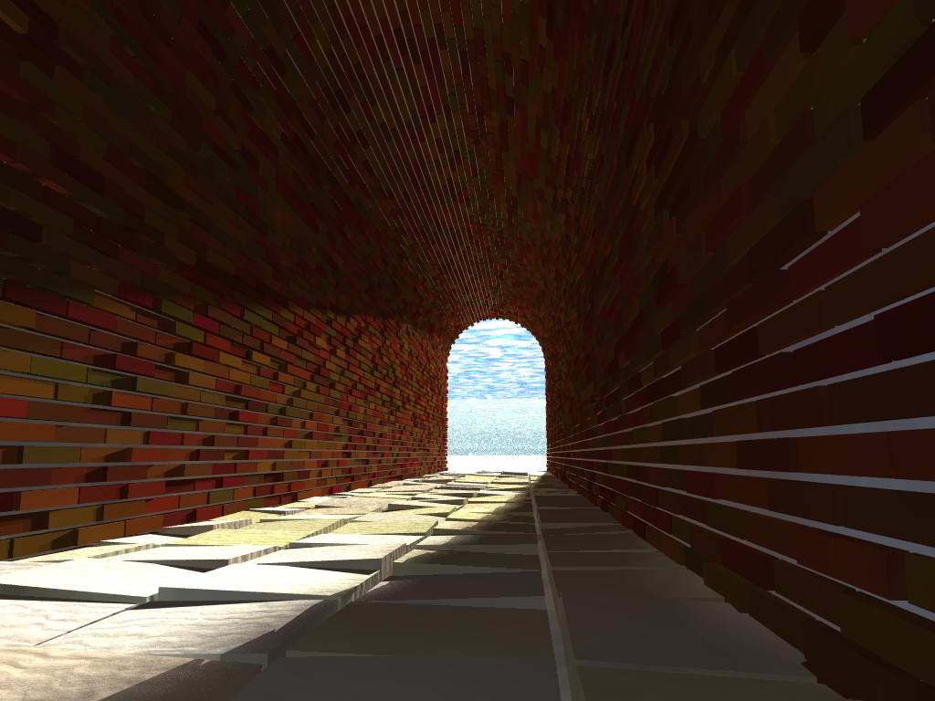

I played around with isosurfaces for the floor, but I really don't have a
good idea how they work, and also the render time would have gone through
the roof. I also tried to put some heightfield mountains in the scene but I
just couldn't get the scaling right, the end of the tunnel is 200 units away
so it makes sense to play the heightfield far away, more than 1000 units,
but I couldn't get it to look right. Despite these problems and a few others
I have made some progress. The script now automatically creates the mortar
and I have randomly rotated the floor tiles, too much perhaps. One thing I
would like to do would be to randomly add some grass/plants in the cracks on
the floor. I'm not sure quite how to do this. It would be nice if I could
have more plants near the walls of the tunnel, but to do this I would need
some form of a probability function, that would make the likelihood of a
plant appearing greater as you approached the walls. Does anyone know how I
could do this, and at the same time restrict the plants to the mortar
spaces?
I used MegaPov radiosity and an arealight here.
Download 'Tunnel 2.JPG' (68 KB)
Preview of image 'Tunnel 2.JPG'

I love the floor, I don't like the background, and it looks like the mortar has
an ambient-setting higher than 0...
cu!

SFSG. Maybe try a slightly rolling heightfield of mossy mud just high enough
to fill in the cracks in the lowest parts of the floor and cover the lowest
parts of the floor tiles.
 -Shay
The floor looks quite good IMO, the walls are a bit strange though: they
are very straight in total, but the position of the single bricks varies
extremely.  Also the mortar seems too bright in the shadow.
> One thing I
Just choose random positions and round to the nearest gap in one
direction.
> spaces?
You can achieve different propabilities by using things like:
#if(rand(Seed)<0.2)
This example would give a propability of 1/5.
Normally you would not need such constructions, because you can simply
influence the total number of plants in one section.
