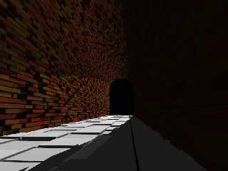

Well my first script has now progressed to the point where I actually have
something of an image to show for it. Since my last post about it I have
fixed most of the problems I was having. The bricks are now staggered; I've
added random translation, probably too much looks like the tunnel would be
labelled a structural hazard, and the bricks are randomly coloured. I've
also added randomly translated flagstones for the floor. Next I need to find
a way to model the grouting. I was thinking of using a difference of two
cylinders for the grouting in the ceiling, what do you guys think?

I've never had much success with MegaPov's isosurfaces but I'm thinking of
adding an isosurface texture to the flagstones, and maybe the bricks. I want
an ancient weathered feel.

You beat me to the punch.  If the bricks were old and decayed then your
geometry would be perfect.  It seems strange to see machine-made perfect
bricks so badly misaligned.
The variation in height on the floor tiles could be toned down a bit, but
overall the effect is wonderful.

I think spinning the floor tiles a little on the z (assuming your camera is
at -z) would improve the effect of the floor buckling over time.
