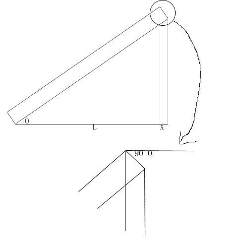

Well this is my first post in about 6 months or so, I've stopped using pov
for quite a while but I've decided to get back into it. This time I'm making
a conceded effort NOT to use a modeller, I've always used Moray, with the
exception of some of my earlier images, and while it is a good modeller I
sorta feel like I'm cheating ;-) Anyway people on this server tend to look
at you funny if you use a modeller, hehe. So to start things off I've
decided to take on a rather hard project. I'm modelling a tunnel made of
individual bricks with a brick floor. This is the first time I've ever used
any of the scripting capabilities of Pov and I have to say I'm enjoying it.
However I have gotten a little stuck with a Geometry/Scripting problem.
Let's see if anyone can help. Here is what I'm trying to do. I want to
create N number of bricks rotated 0 (theta) degrees. I want the bricks to be
placed end to end vertically. After about 2 hours of working this out of
paper I boiled the translation on the y axis down to this formula.
tan(0+atan2(boxh,boxw))*(cos(90-0)*boxw-cos(0)*boxh)
where 0 = theta and boxw = width and boxh=height
0 here is the angle I rotate the box. On the diagram below L is
cos(90-0)*boxw-cos(0)*boxh.
However I want the altitude up to the top of the corner, this forms a right
triangle with the diagonal of the box as a hypotenuse and L as the base.
However theta of THIS triangle is different from theta the theta on the
diagram bellow. In order to get the new angle I add the angle formed by the
base of the box and its diagonal given by atan2(boxh,boxw) to 0. I don't
know if this makes ANY sense to anyone. Anyhow the formula seems to work, a
little. As long as the angle is 45 or -45 it works perfectly, however
anything other than 45 doesn't work. I'm only in Math 12 now so there is
probably a much more consise way of doing this, but this is the way that
seemed best to me. Bellow is the entire scene file.

Download 'diagram.gif' (6 KB)
Preview of image 'diagram.gif'

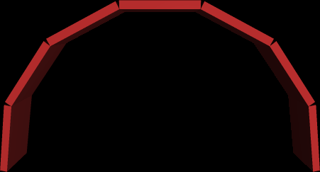

Is this what you want?
  #include "colors.inc"
  #include "finish.inc"
  #declare boxh = 1;
  #declare boxw = 10;
  #declare boxl = 8;
  #declare Mybox =
  box{
   <-boxw/2,0,-boxl/2>
   <boxw/2,boxh,boxl/2>
   texture{
    pigment {Firebrick}
    finish {Shiny}
  camera {
          location 2.5*<0,8,-20>
          look_at <0,0,0>
#declare BrickLength = 10;
#declare BricksInArch = 7;
#declare BrickAngle = 180/BricksInArch;
#declare ArchRadiusB = pow(pow(BrickLength,2)/(2*(1-cos(radians
(BrickAngle)))),.5);
#declare ArchRadius =
pow((pow(BrickLength,2)*(1+cos(radians(BrickAngle))))/(4*(1-cos(radians(BrickAngle)))),.5);
#macro R (Offset,Rotate)
        rotate -90*z translate Offset*x rotate Rotate*z
#end
#macro R2 (Block,NumBlocks,Angle,Radius)
         #local N = 0;
         #while (N<NumBlocks)
           object {Block R(Radius,Angle*N+Angle/2)}
           #local N = N + 1;
         #end
#end
R2 (Mybox,BricksInArch,BrickAngle,ArchRadius)
  light_source {<10,6,-100> rgb 2}
Dan Johnson
http://www.geocities.com/zapob
Download 'brickarch.gif' (7 KB)
Preview of image 'brickarch.gif'

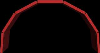

Wow actually that is exactly what I wanted, but I solved the problem another
way, actually I completely circumnavigated it:-) Take a look at my script in
p.t.scene-files. I'll have to take a look at your code when I get the time
though.
