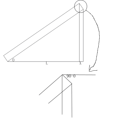

0 here is the angle I rotate the box. On the diagram below L is
cos(90-0)*boxw-cos(0)*boxh.
However I want the altitude up to the top of the corner, this forms a right
triangle with the diagonal of the box as a hypotenuse and L as the base.
However theta of THIS triangle is different from theta the theta on the
diagram bellow. In order to get the new angle I add the angle formed by the
base of the box and its diagonal given by atan2(boxh,boxw) to 0. I don't
know if this makes ANY sense to anyone. Anyhow the formula seems to work, a
little. As long as the angle is 45 or -45 it works perfectly, however
anything other than 45 doesn't work. I'm only in Math 12 now so there is
probably a much more consise way of doing this, but this is the way that
seemed best to me. Bellow is the entire scene file.

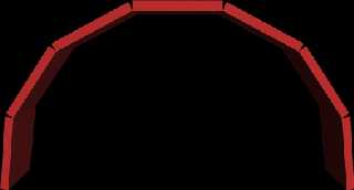

From: Dan Johnson
Subject: Re: Pov Geometry prob
Date: 14 May 2001 18:51:20
Message: <3B01B317.40E50C26@hotmail.com>
Is this what you want?
  #include "colors.inc"
  #include "finish.inc"
  #declare boxh = 1;
  #declare boxw = 10;
  #declare boxl = 8;
  #declare Mybox =
  box{
   <-boxw/2,0,-boxl/2>
   <boxw/2,boxh,boxl/2>
   texture{
    pigment {Firebrick}
    finish {Shiny}
  camera {
          location 2.5*<0,8,-20>
          look_at <0,0,0>
#declare BrickLength = 10;
#declare BricksInArch = 7;
#declare BrickAngle = 180/BricksInArch;
#declare ArchRadiusB = pow(pow(BrickLength,2)/(2*(1-cos(radians
(BrickAngle)))),.5);
#declare ArchRadius =
pow((pow(BrickLength,2)*(1+cos(radians(BrickAngle))))/(4*(1-cos(radians(BrickAngle)))),.5);
#macro R (Offset,Rotate)
        rotate -90*z translate Offset*x rotate Rotate*z
#end
#macro R2 (Block,NumBlocks,Angle,Radius)
         #local N = 0;
         #while (N<NumBlocks)
           object {Block R(Radius,Angle*N+Angle/2)}
           #local N = N + 1;
         #end
#end
R2 (Mybox,BricksInArch,BrickAngle,ArchRadius)
  light_source {<10,6,-100> rgb 2}
Dan Johnson
http://www.geocities.com/zapob
Download 'brickarch.gif' (7 KB)
Preview of image 'brickarch.gif'

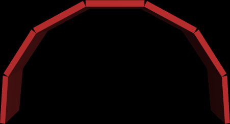

From: Thomas Lake
Date: 15 May 2001 03:20:27
Message: <3b00d8bb$1@news.povray.org>
Wow actually that is exactly what I wanted, but I solved the problem another
way, actually I completely circumnavigated it:-) Take a look at my script in
p.t.scene-files. I'll have to take a look at your code when I get the time
though.
