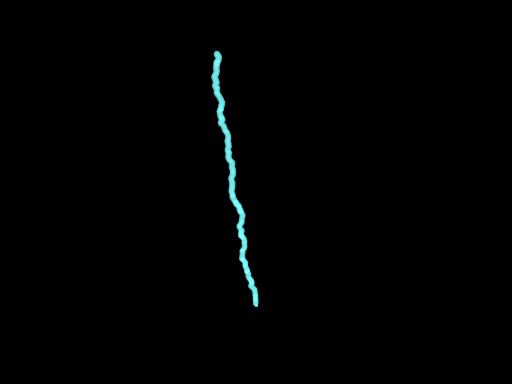

My first try at lightning.
I can't seem to get it to show on any other background though. I also still
need to figure out how to do the branches.
The code is posted to p.t.s
Comments and help welcome.
Nekar

From: ingo
Subject: Re: Lightning WIP
Date: 28 Apr 2001 06:06:11
Message: <Xns90917B7B789B3seed7@povray.org>
Add absorbing media, with complement colour to the emitting media.
Ingo
From: Nekar Xenos
Date: 28 Apr 2001 06:09:14
Message: <3aea96ca@news.povray.org>
I've got it working now.
Thanks
Nekar
From: Gail Shaw
Date: 28 Apr 2001 07:11:47
Message: <3aeaa573@news.povray.org>
Nekar Xenos <j-p### [at] citywalkcoza> wrote in message
news:3aea8c3a@news.povray.org...
still
Make it recursive.
#macro lightning(......)
 #if (ChanceToBranch < rand(rnd))
    lightning(.......)
 #end
#end
ChanceToBranch should decrease each time
it recurses so that the macro will finish at some time.
I've got some lightning code that I never finished. If you like
I'll post it.
Gail
