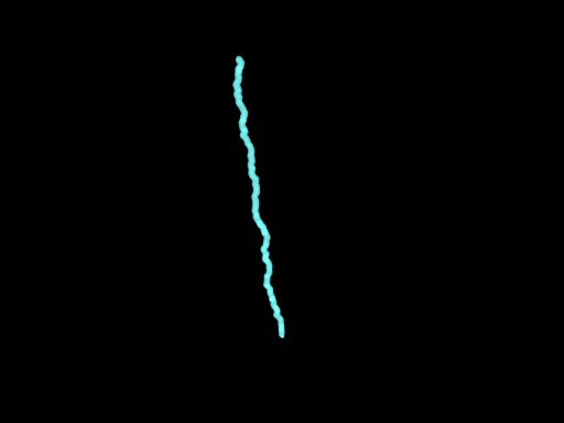

My first try at lightning.
I can't seem to get it to show on any other background though. I also still
need to figure out how to do the branches.
The code is posted to p.t.s
Comments and help welcome.
Nekar
Download 'Lightning.jpg' (6 KB)
Preview of image 'Lightning.jpg'
Add absorbing media, with complement colour to the emitting media.
Ingo

I've got it working now.
Thanks

Nekar Xenos <j-p### [at] citywalkcoza> wrote in message
news:3aea8c3a@news.povray.org...
still
Make it recursive.
#macro lightning(......)
 #if (ChanceToBranch < rand(rnd))
    lightning(.......)
 #end
#end
ChanceToBranch should decrease each time
it recurses so that the macro will finish at some time.
I've got some lightning code that I never finished. If you like
I'll post it.
Gail

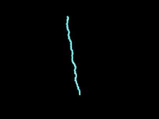

I while ago I wrote a macro for lightnings .. I'll see, if I can find it again ...
here is a pic I did with it ...
background{rgb 1}camera{location<1,5,-2>look_at 0}#macro m(a,b,i)#local d=(b-a)
/8;#local e=vcross(d,y);#if(i)m(a-e,a+e+2*d,i-1)m(a+e,a+2*d-e,i-1)m(a+3*d-e,a+e
+3*d,i-1)m(a+3*d-e,a+5*d-e,i-1)m(a+6*d-e,a+e+6*d,i-1)m(a+8*d-e,a+e+8*d,i-1)#else
cylinder{a,b,vlength(d)/3 pigment{rgb 0}}#end#end m(-4*x,2*x,4) // Jan Walzer
Download 'img1.png' (65 KB)
Preview of image 'img1.png'

We're off today at work but I came in just to upload my modifications and
now it seems the stiffy I put it on is messed up. Will bring it in tomorrow.
I first tried making branches at random intervals, but I couldn't get it to
be infrequently enough. I've just thought of something - maybe if I tried
#declare ChanceToBranch = 0.01
#if  (ChanceToBranch > rand(md))
       lighningbranch...
I think this is basically the same as your example below except I haven't
tried a macro yet.
At the moment I've got it to make three branches but I'd like to be able to
specify x amount of branches and y amount of sub-branches for instance.
Something like a modified tree macro.I first tried making branches at random
intervals, but I couldn't get it to be infrequently enough. I've just
       lighningbranch...
> Make it recursive.
>     lightning(.......)
>  #end
> #end
Thanks. I'm not sure what that 'md' is you've got in the rand statement, can
you explain a little more - unless md is the seed of course.
> I'll post it.
That would be wonderfull - thank you.
Nekar

Not exactly what I was looking for, but can you remember how you did the
branching? (This is more like sparks than lightning)
Nekar
can
Sorry, I always have a random stream called rnd, makes it easier
to remember variable names.
so
#declare rnd=seed(8393);
> > I'll post it.
If I've got a copy with me I'll post it, otherwise on
wednesday. Look in p.t.s-f
Gail
