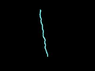

My first try at lightning.
I can't seem to get it to show on any other background though. I also still
need to figure out how to do the branches.
The code is posted to p.t.s
Comments and help welcome.
Nekar

From: ingo
Subject: Re: Lightning WIP
Date: 28 Apr 2001 06:06:11
Message: <Xns90917B7B789B3seed7@povray.org>
Add absorbing media, with complement colour to the emitting media.
Ingo
From: Nekar Xenos
Date: 28 Apr 2001 06:09:14
Message: <3aea96ca@news.povray.org>
I've got it working now.
Thanks
Nekar

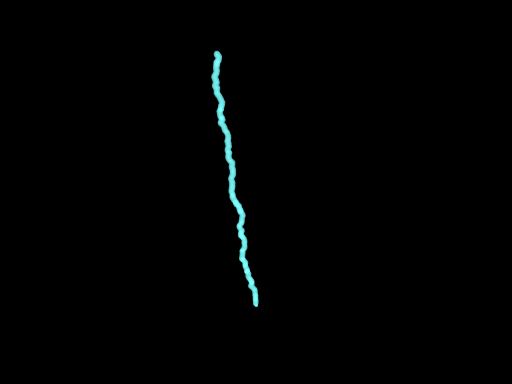

From: Jan Walzer
Date: 28 Apr 2001 17:02:04
Message: <3aeb2fcc@news.povray.org>
I while ago I wrote a macro for lightnings .. I'll see, if I can find it again ...
here is a pic I did with it ...
background{rgb 1}camera{location<1,5,-2>look_at 0}#macro m(a,b,i)#local d=(b-a)
/8;#local e=vcross(d,y);#if(i)m(a-e,a+e+2*d,i-1)m(a+e,a+2*d-e,i-1)m(a+3*d-e,a+e
+3*d,i-1)m(a+3*d-e,a+5*d-e,i-1)m(a+6*d-e,a+e+6*d,i-1)m(a+8*d-e,a+e+8*d,i-1)#else
cylinder{a,b,vlength(d)/3 pigment{rgb 0}}#end#end m(-4*x,2*x,4) // Jan Walzer
Download 'img1.png' (65 KB)
Preview of image 'img1.png'
From: Nekar Xenos
Date: 30 Apr 2001 06:02:42
Message: <3aed3842@news.povray.org>
We're off today at work but I came in just to upload my modifications and
now it seems the stiffy I put it on is messed up. Will bring it in tomorrow.
I first tried making branches at random intervals, but I couldn't get it to
be infrequently enough. I've just thought of something - maybe if I tried
#declare ChanceToBranch = 0.01
#if  (ChanceToBranch > rand(md))
       lighningbranch...
I think this is basically the same as your example below except I haven't
tried a macro yet.
At the moment I've got it to make three branches but I'd like to be able to
specify x amount of branches and y amount of sub-branches for instance.
Something like a modified tree macro.I first tried making branches at random
intervals, but I couldn't get it to be infrequently enough. I've just
       lighningbranch...
> Make it recursive.
> #macro lightning(......)
>  #if (ChanceToBranch < rand(rnd))
>     lightning(.......)
>  #end
> #end
> ChanceToBranch should decrease each time
> it recurses so that the macro will finish at some time.
Thanks. I'm not sure what that 'md' is you've got in the rand statement, can
you explain a little more - unless md is the seed of course.
> I've got some lightning code that I never finished. If you like
> I'll post it.
That would be wonderfull - thank you.
Nekar
From: Nekar Xenos
Date: 30 Apr 2001 06:22:40
Message: <3aed3cf0@news.povray.org>
Not exactly what I was looking for, but can you remember how you did the
branching? (This is more like sparks than lightning)
Nekar
